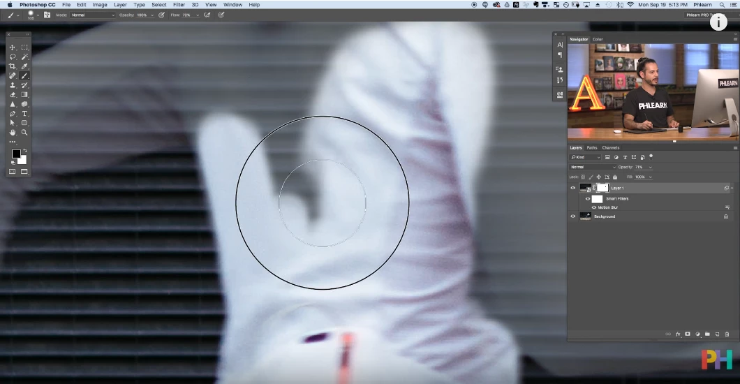

While I was watching this tutorial: How to Add Motion Blur to Backgrounds in Photoshop - YouTube​, I realized that Aaron has both the normal and full brush sizes visible. (Look at 8:07) Does anyone know how this can be achieved? It makes masking and blending much easier especially when you have a lower hardness by allowing you to see the outmost edge and the innermost brush.

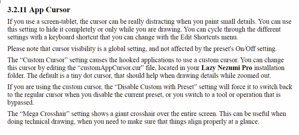

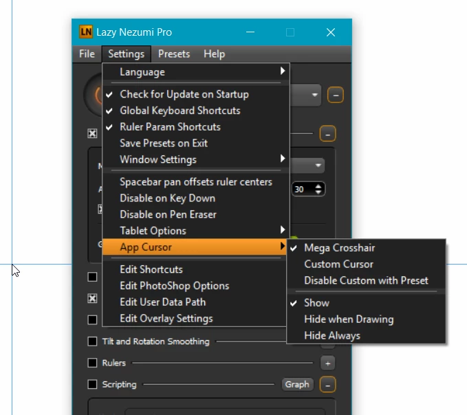

Lazy Nezumi Pro has some additional cursor options.  The blue cross hairs below is the 'Mega Croshair' and extends to the edge of the main screen.
I've never felt the need to try the Custom Cursor option, but from the documentation...
.cur files are Windows static cursor files, and identical to .ico (other than the extension, so you could make your own with something like Telegraphics ICO plugin for Photoshop, but seeing as they are static, and would not change with the brush size, I am not sure how useful they might be.

I also tried out Lazy Nezumi and the cursor still doesn't give you the inside brush, but I'll use it for a bit and see how I feel about it. Thanks!

I'm wondering if that is to do with the screen capture software he is using.   (Camtasia or Adobe Captivate?)  I don't know how to enable it with Photoshop at least.

That might be an anomaly created by whatever screen recording software the person is using.
Al ot of screen recording software can be set to use it's own cursors when doing a screen recording.
I don't believe there are any photoshop settings that mimic that.
