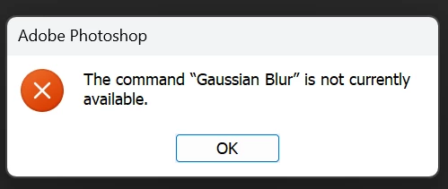

I'm trying to make a script to apply gaussian blur to the entire image, but I was unable to select the layer and apply the filter to the layer.
app.activeDocument.activeLayer = app.activeDocument.layers[0];
app.activeDocument.activeLayer.hasSelectedArtwork = true;
app.activeDocument.activeLayer.applyGaussianBlur(150.0);
I got a window alert with the message: "The command "Gaussian Blur" is not currently available" as seen in the attached image
Thanks for your help!
Marcio

pixxxelschubser
June 4, 2024
Are you in the right forum?
Is this really a Photoshop script question?
Was the script created by yourself or by ChatGPT?
Because ‘hasSelectedArtwork’ is part of the Illustrator DOM.

But the method »applyGaussianBlur« exists in Photoshop’s DOM.
pixxxelschubser
pixxxelschubserCommunity ExpertCorrect answer
June 4, 2024
Yes.
@mslino65
And for the beginning:
This code snippet opens in Photoshop the dialogue for the Gaussian blur with the value specified in the script.
app.displayDialogs = DialogModes.ALL;
app.activeDocument.activeLayer.applyGaussianBlur(30);

Could you please post screenshots with the pertinent Panels (Toolbar, Layers, Options Bar, …) visible?
What is »hasSelectedArtwork« supposed to be?
Though photoshop-javascript-ref-2020.pdf is obviously not up to date I don’t know a newer version and I failed to find a reference to the property there.
