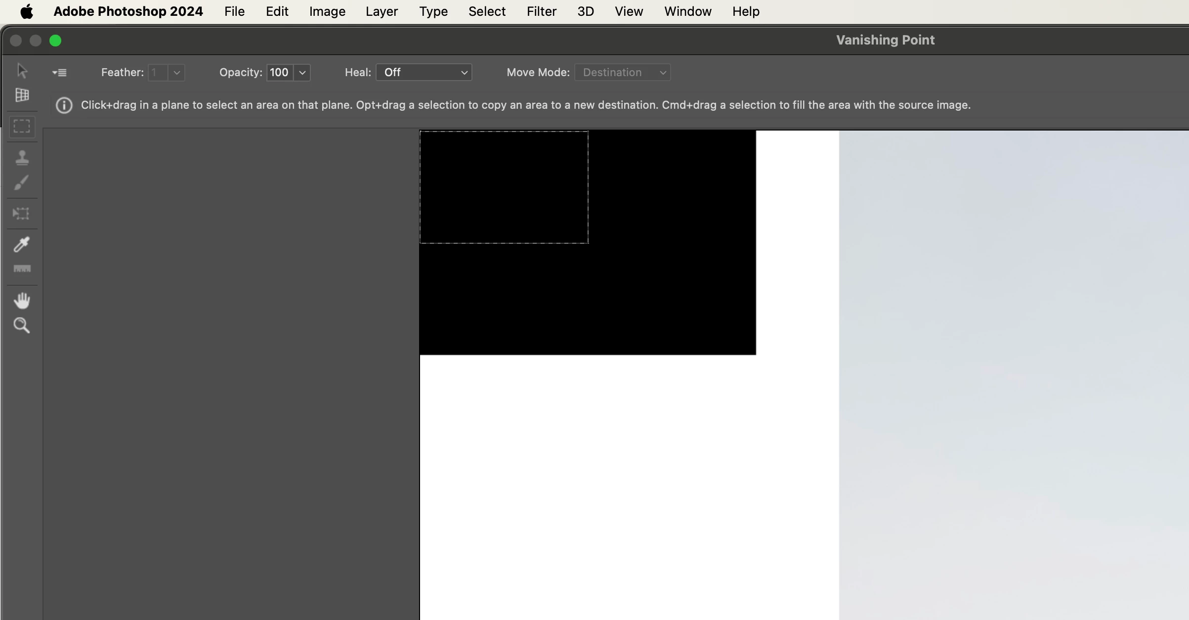

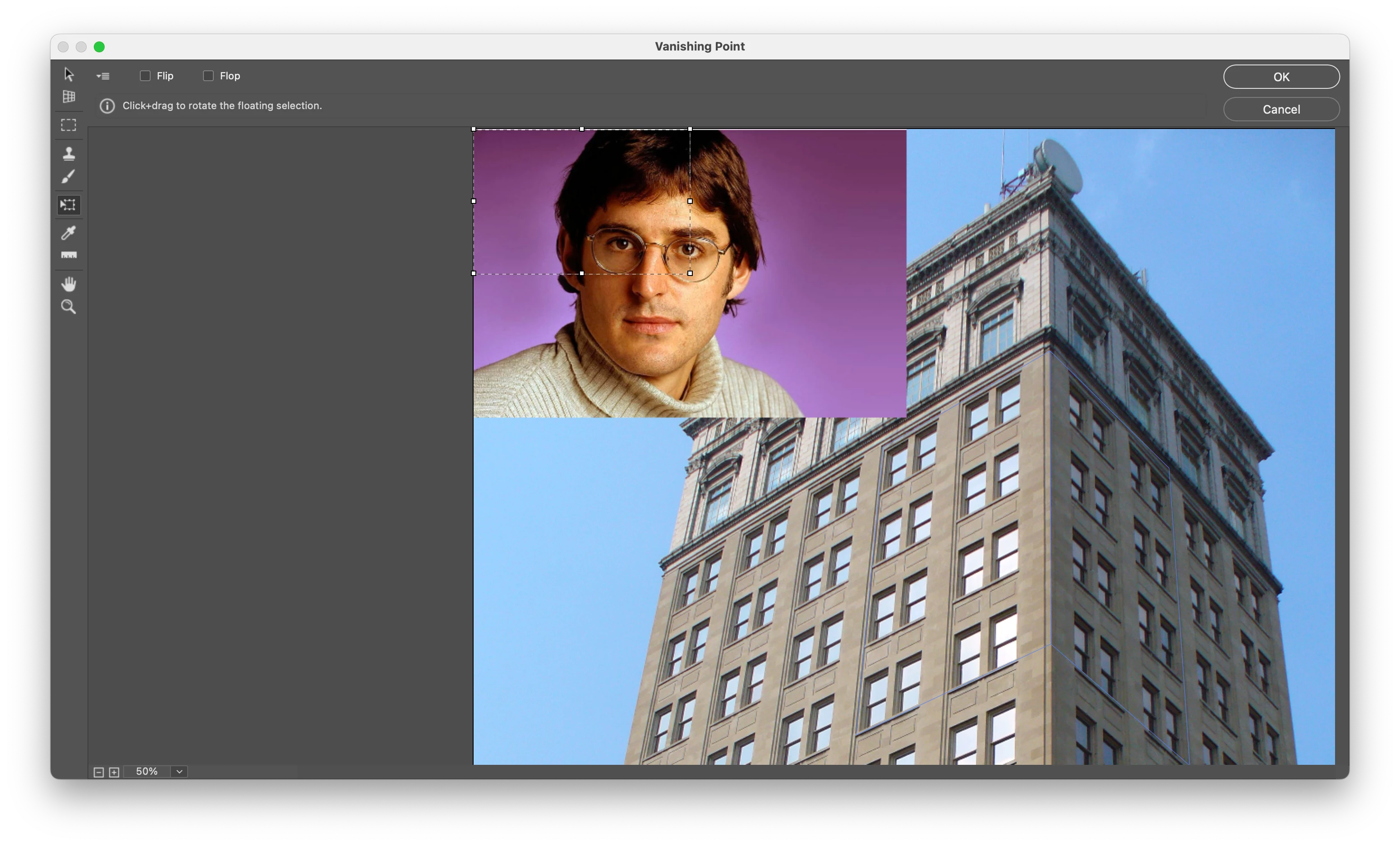

When I paste content in Vanishing Point tool, the content's bounding box does not match the size of nor aligns with the content itself.

I see the problem now - the image is coming in much larger than the boudnding box. Now all the screenshots makes sense. I don't know what the issue is or how to fix it. You can try to reset Photoshop prefs but I'm not sure if it will help here. Hopefully someone else will chime in.

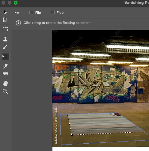

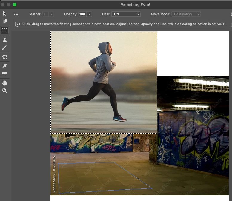

Sorry, melissapiccone, I must not have explained well enough, but cutefunk's screenshots do a good job at showing the problem.
Take a closer look at my screenshot and cutefunk's second-to-last screenshot, then compare it to your first screenshot. Look at the dotted line/bouding box of the pasted content. In our screenshots, the dotted line does not line up with its content. In your's, the dotted line does line up with its content.
This wouldn't necessarily be a problem except when I drag that content into the perspective plane, the content does not behave in a way that is unsable at all. Look at cutefunk's 4th and 5th screenshot. This is what happens when you drag the dotted box in the place—the content doesn't line up. And if you try to counteract this by moving the dotted box to a weird place, the pasted content starts behaving unpredictably.

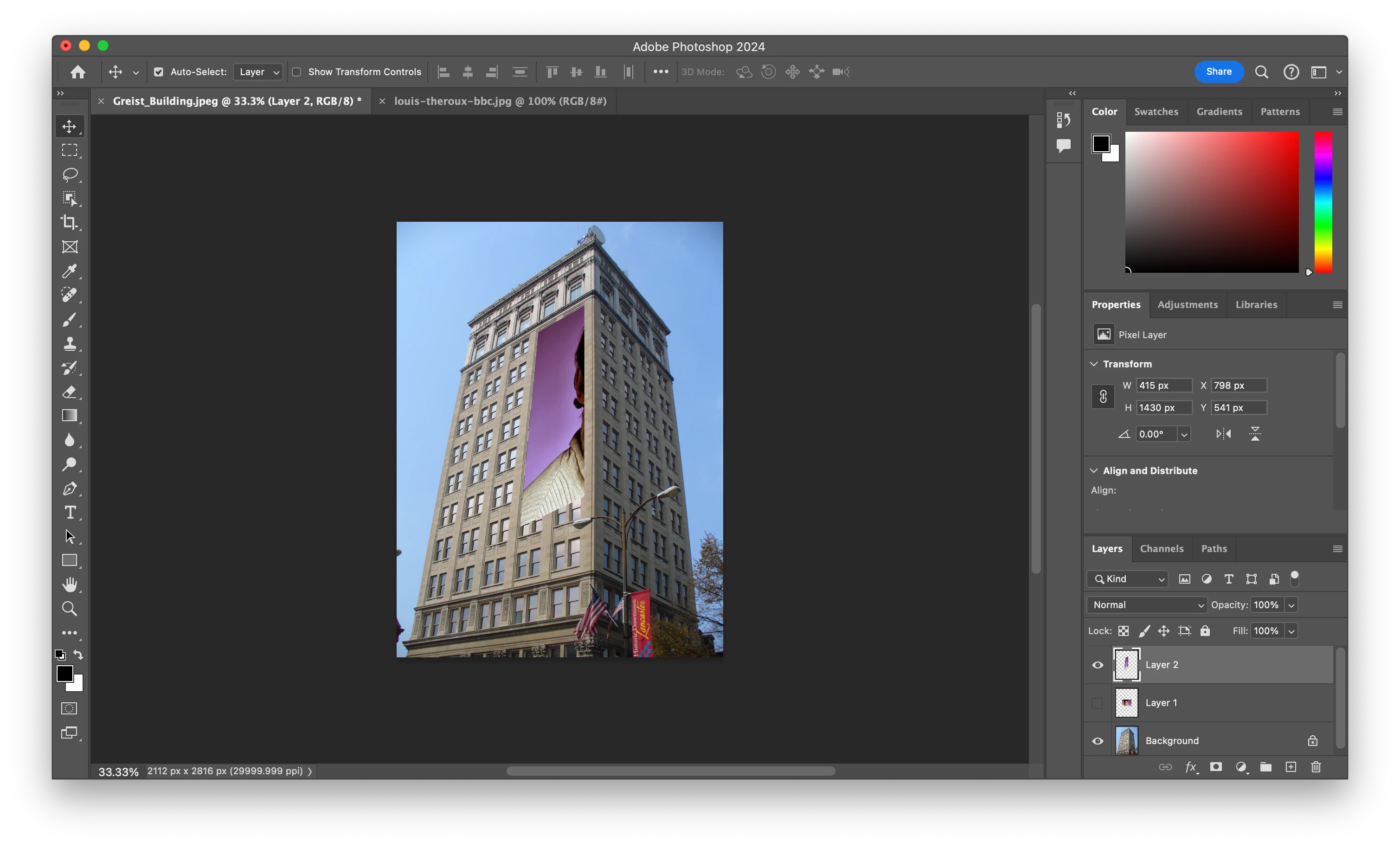

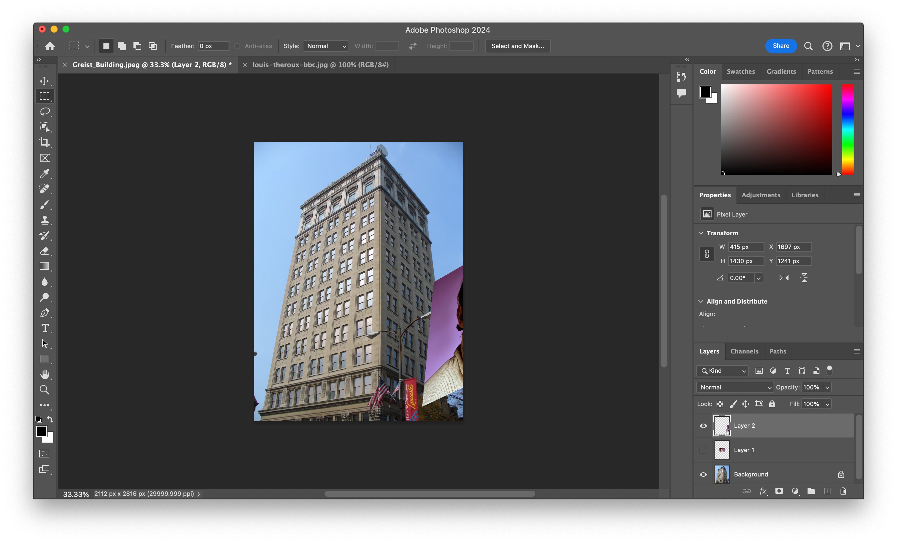

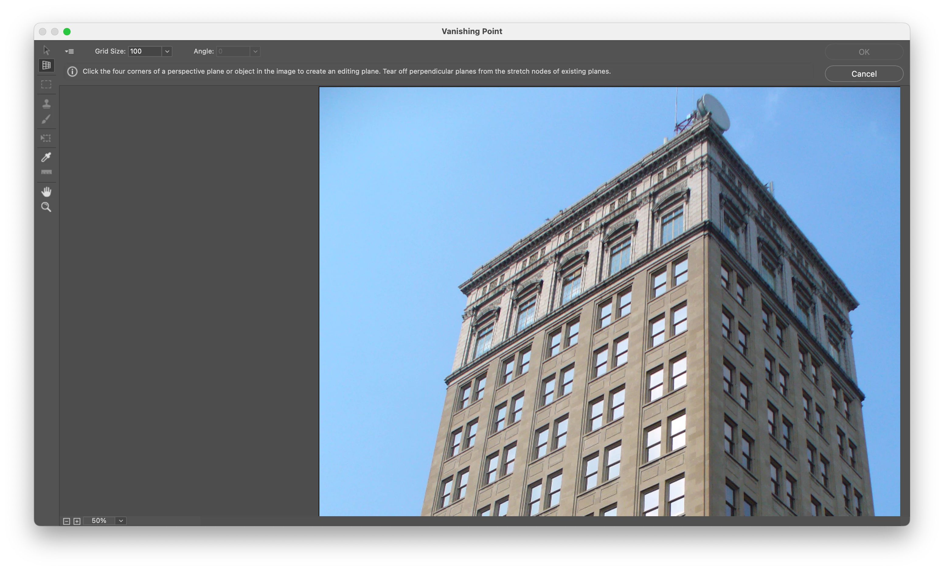

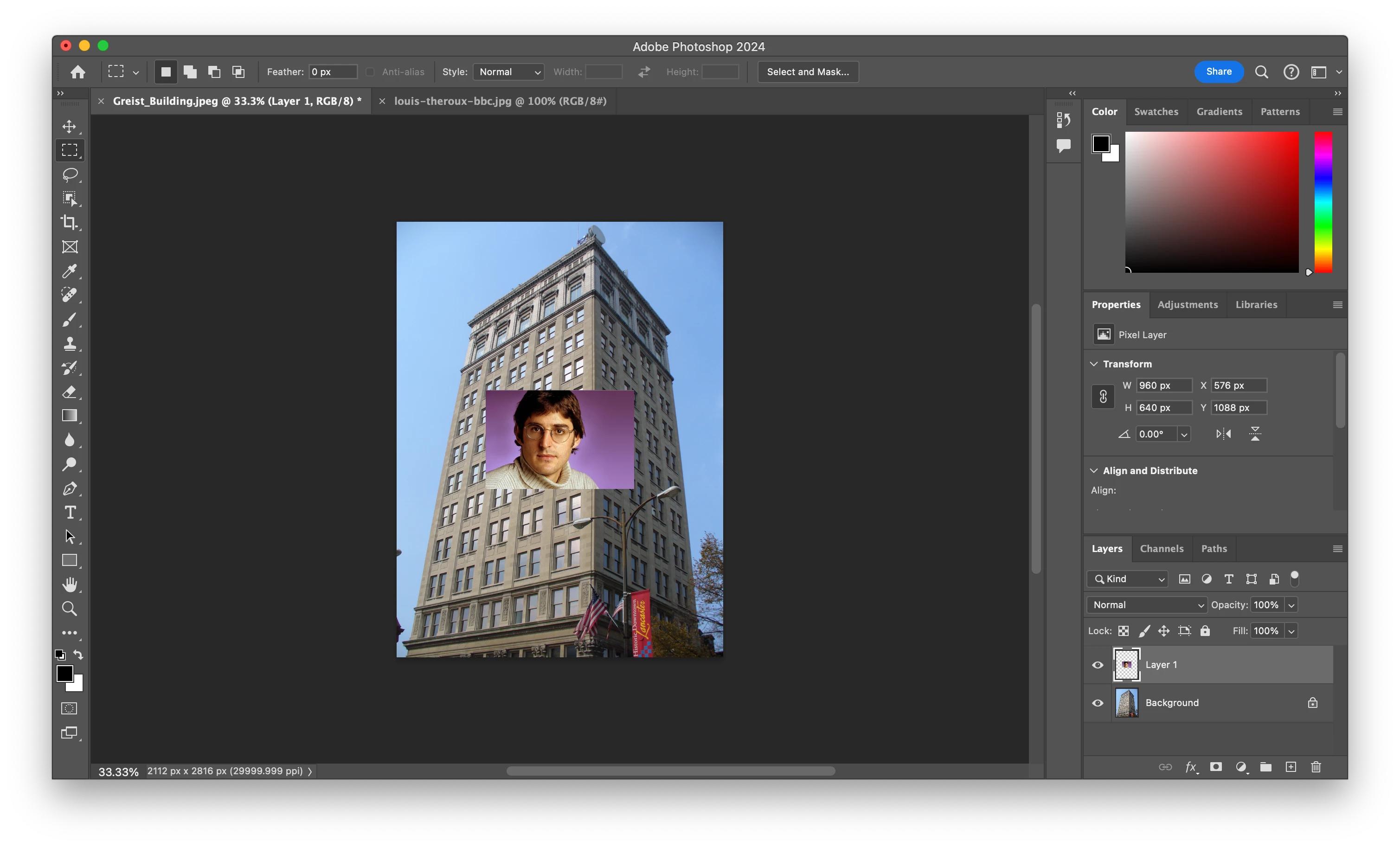

I have the same issue. When I open up Vanishing Point I can't scroll around - when I zoom in I can't scroll to work in more detail. When I paste in any artwork to put into the vanishing point, when I go to re-size the box isn't even properly around the artwork (marque covers 25% top left of whatever the artwork is). When I put in the vanishing point, when I come out of vanishing point it's at another place on the artboard with the artwork expanded but cut to size of what the vanishing point should be.
The black box in the example with the marque tool around 25% of the artwork is what I get when trying to scale the artwork.
I've added images to try and give a better idea of what seems to be happening to me and the original poster.
