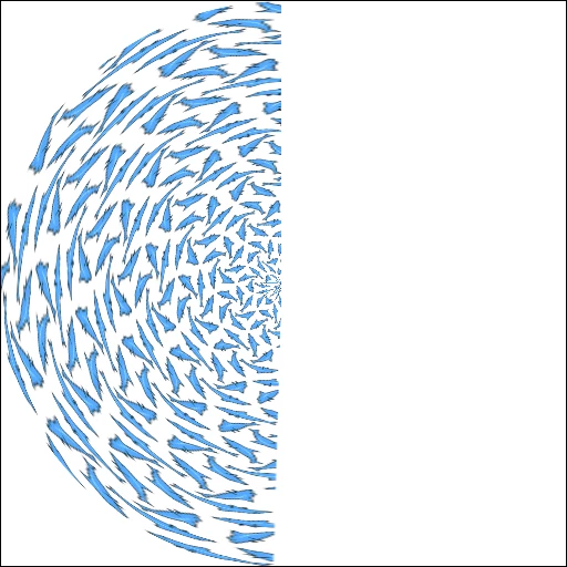

    You can do this via Polar Coordinates. Just be sure the subject is only on the right or left half of the canvass.
    After Polar Coordinates:

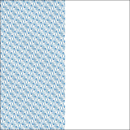

    You could then rotate the results if you like. Unfortunately, the outer edge will look smeared. Stars would become short, arced streaks. You can get around this (sort of) by starting with an image 6.28 times wider than the final, and then scaling the width down to the final size before the Polar Coordinates.
    Now the stretching is in the middle.

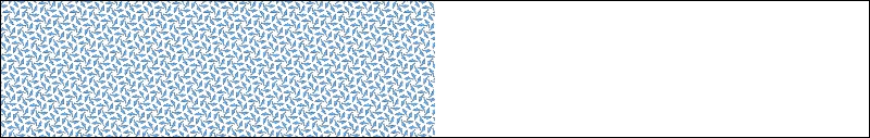

    I used 6.28 because that is 2 x pi. So, I started with a doc like this (Width is 6.28 x the Height):

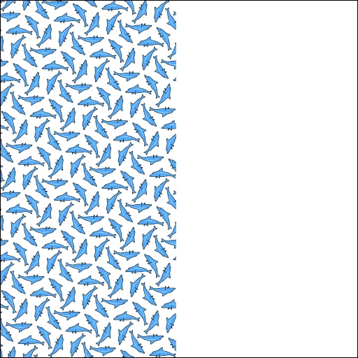

    and then scaled the width so the image would be a square:

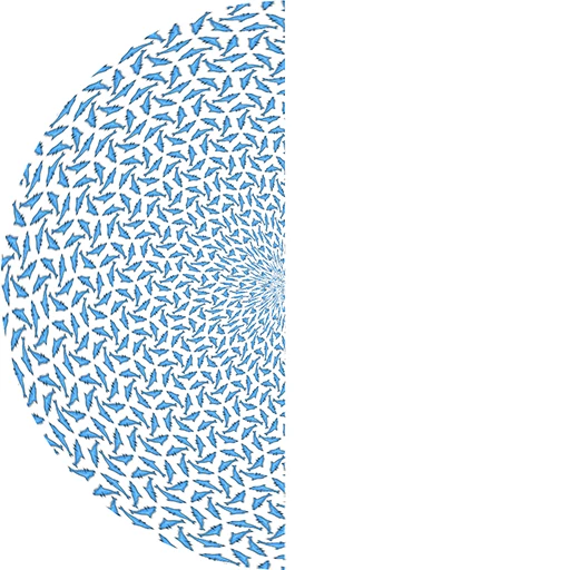

    Now the image looks "squashed", and when it's Polar Coordinated and "stretched", the outside will look "normal".

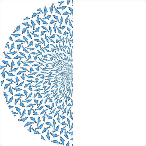

    Here's a version with an original aspect ratio of 3.14 (pi), and done as above; in this, the "normal" part is about halfway out from the middle (a compromise):
    A couple of notes: The two transformations can really degrade the image quality, so it's best to start with the largest size you can. Also, in these examples, the bottom edge becomes the circumference, the left and right edges combine to make the diameter (two radii), and the top edge is collapsed into the center.
