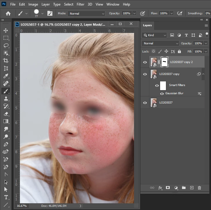

So bizarre; layers, masking and brush tool trainwreck
  • June 25, 2020
  • 452 views
Follow me here:
Image>
Establish 3 layers> (command J)
Disable the top layer, choose middle, apply gausian blur>
Enable top layer, add mask to TOP layer, (white)>
Brush is black, apply brush to mask>
(here's the problem)  When I brush the mask on the top layer to reveal the middle layer, the middle layer reverts back to in-focus, meaning the blur goes away!  I've been using PS since version 5.5 and NEVER seen this freaky thing.  WHAT is happening?  I've looked at every setting I know to check and nothing works to fix it.  I reset the brush, nothing.  SO bizarre.
Video here: https://youtu.be/0lU1o9C-i_0

davescm
June 25, 2020
Can you try going to Preferences > Performance and uncheck Legacy Compositing . Then restart and try again
Dave

davescm
June 26, 2020
The compositing engine at the heart of Photoshop has been updated over the last few versions.  Legacy Compositing was provided as a fall back whilst any bugs in the new were resolved. Unfortunately in the latest version the use of the old legacy compositing engine introduced a new issue with screen redraw. However, most are now able to use the new engine reliably and without issues.
So, the bottom line is that wherever possible (unless you get specific issues on your hardware) the box should now be unchecked to use the newer compositing engine.
