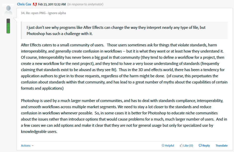

Not because I'm an expert on this, but I remember former PS engineer Chris Cox wrote several long posts about transparency and alpha channels, the gist of which was that they weren't the same thing. Here's one that I for some reason kept. He's talking about alpha channels here:
I don't have any opinions here. But maybe this is what he was talking about.
buck-wAuthor
April 19, 2022
Interesting to read.
Complete BS.  Photoshop is the one being obtuse here.  A file is 32bit and has a mask within, or it does not.  I have two 32bit images that act differently.  Very confusing.  I don't think it is standards so much as PS evolutionary weirdness.
