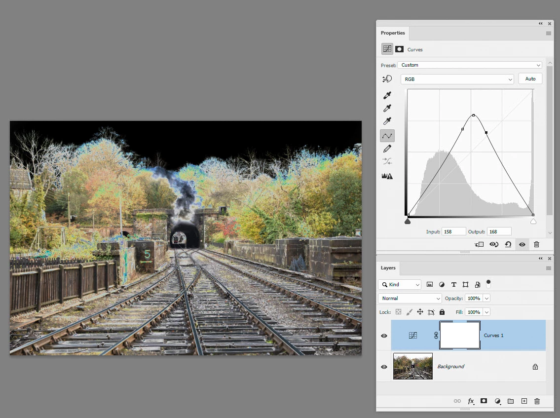

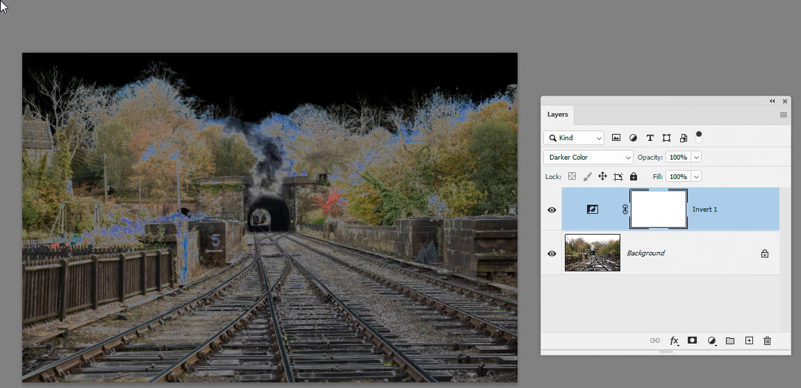

You can though create a controlable solarised effect by either:
a. Using a curve
or
b. Using an invert adjsutment layer and changing the blend mode and opacity
Dave
