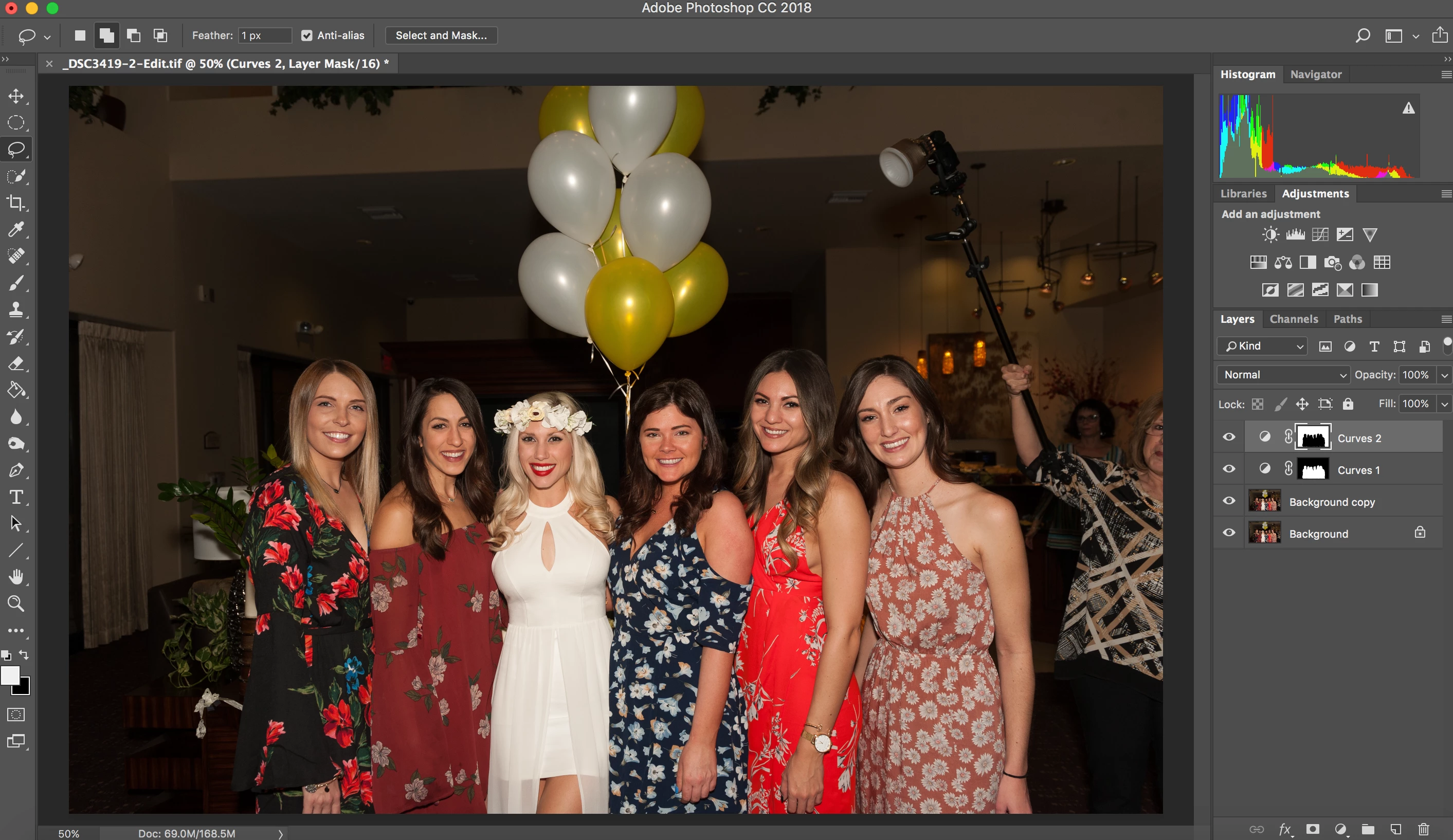

What I did was to duplicate the original layer and I worked on the layer copy.
This is what my screen looks like:
When I went into the Select and Mask Tool I was working on the "Background Copy" layer.
thanks again Dave!
best to you,
Rick
davescm
davescmCommunity ExpertCorrect answer
January 30, 2018
So when you use onion skin and on layers on the background copy, and add a mask, you are revealing the image underneath which in you case is the background layer. Because the two images are the same it looks as if nothing is happening.
Try turning the original background off or put another image in between them and you will see what I mean.
Dave
