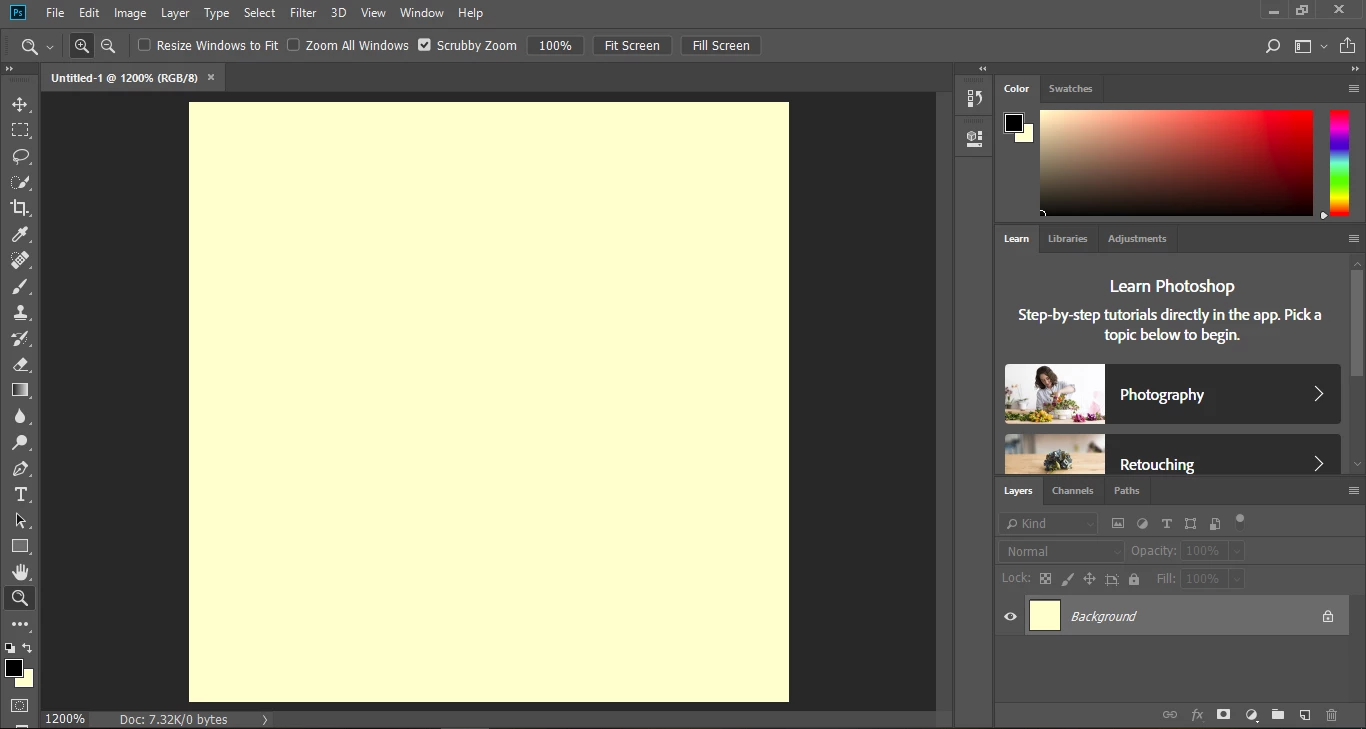

Something is wrong with color,white looks yellowish.
  • May 25, 2019
  • 1992 views
this problem is only in photoshop , the monitor is fine.The only work I did before on Photoshop was editing a few images to black and white.I tried resetting the preferences but nothing worked.

    If nothing of the above working with you, try to reset your Photoshop.
    To restore preferences quickly using a keyboard shortcut:
    Press and hold Alt+Control+Shift (Windows) or Option+Command+Shift (Mac OS) as you start Photoshop. You are prompted to delete the current settings. The new preferences files are created the next time you start Photoshop.

    What happens the you click on the two little squares (above the larger squares) to reset the black and white?
    D Fosse
    May 25, 2019
    Nothing will happen, Derek. It's a broken monitor profile, with the wrong white point.

    The OP said it only happens in Photoshop ...
