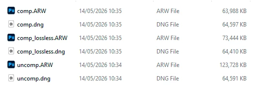

    This made me curious, so I tried with my a7rV. I just let LrC do the conversion here; I don’t have the DNG converter installed.
    All the DNGs are basically the same size, although the ARWs are very different:
    The conclusion I draw from this, is that Sony’s compression algorithm is basically irrelevant to the DNG encoding. The original sensor data are extracted from the ARWs regardless of how it’s encoded, and then the DNG encoding follows its own compression algorithm.
    I mostly use compressed lossless myself - not to save disk space, which I don’t care about, but to stretch the SD card capacity a little longer.
    Small differences may just be the file header and metadata.
