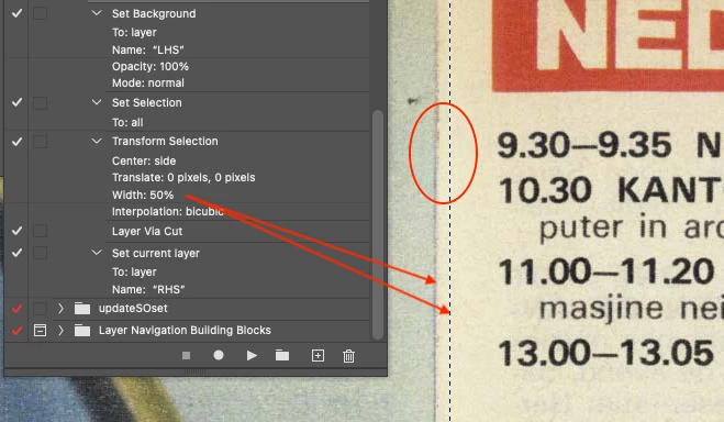

In the following screenshot, the 50% selection of the canvas width does not perfectly match the centre point of the scan:
If there is a consistent "offset" or "bias" this can be accounted for.

I have illustrated how this can be performed via an action. You can use Batch, Droplet, Image Processor or Image Processor Pro scripts to name a few methods of applying an action in bulk.
You have to account for the offset somehow, either accepting this as the price to pay for automation or overcome the issue with pre-processing or an interactive process when batching.
As illustrated in the action, it is also possible to name the left and right hand pages. You can run two separate batches for the front or back of the printed sheet.
A script can save out the layers with the filename + layer name. This can be recorded into the action or a separate script could be made so that an action isn't required.
