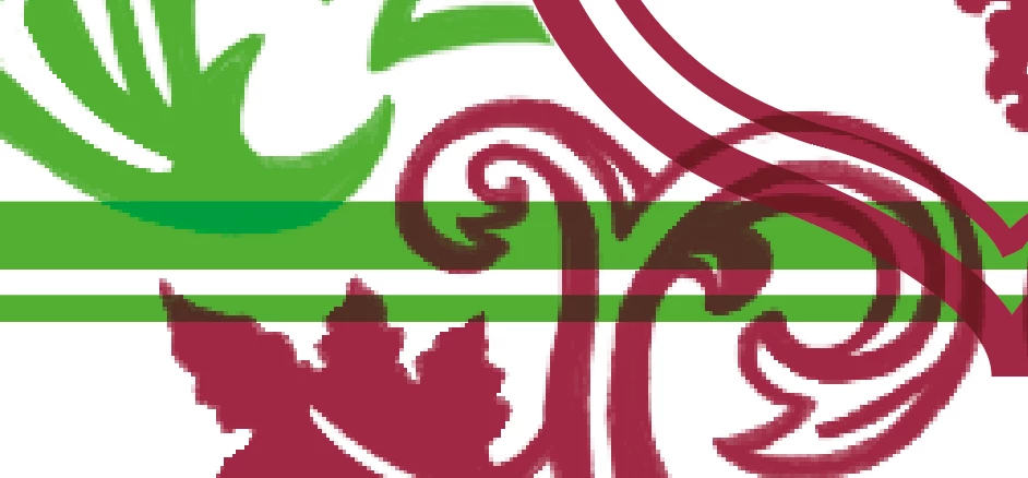

So, I have some elements in Photoshop set to print as Spot colours via Spot Channels. When I bring this file into Illustrator, it shows as overprrinting. Is there a way to stop them overprinting? If they were CMYK they would knockout by default... that I all I want of these Spot channles.

Could you please post screenshots with the pertinent Panels (Toolbar, Layers, Channels, Options Bar, …) visible?
In Photoshop you need to manage knockouts/overprints of Spot Channels yourself, which in this case probably means manually knocking out the affected parts in the Channels.

Thanks. I understand your reply re managing knocking out in Photoshop, but wht then when you combine with Illustrator elements?
An illsutraor gave the more decorative bits as a Photoshop file, but the rules and more graphic elements, which are in the same colours, we would do in Illustrator for true lines. See attached.

I guess you need to create a choked white Layer then; 1 or 2px might suffice.
What is the psd’s Blend Mode in Illustrator?
Please post more meaningful screenshots that include the pertinent Panels.
