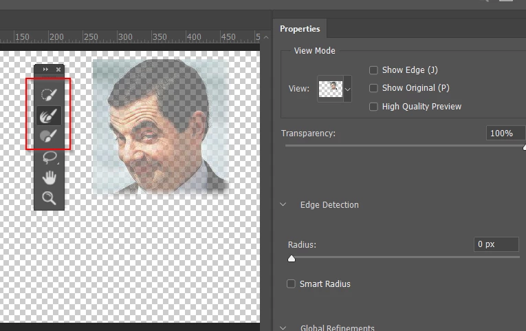

That's an interesting question.  AFAICT there are no alternative preset options in Select & Mask.  The only way I can think of using a square brush to make selections, is with Quick Mask which is highly flexible.
There are three brushes in S&M, so can you be more specific?

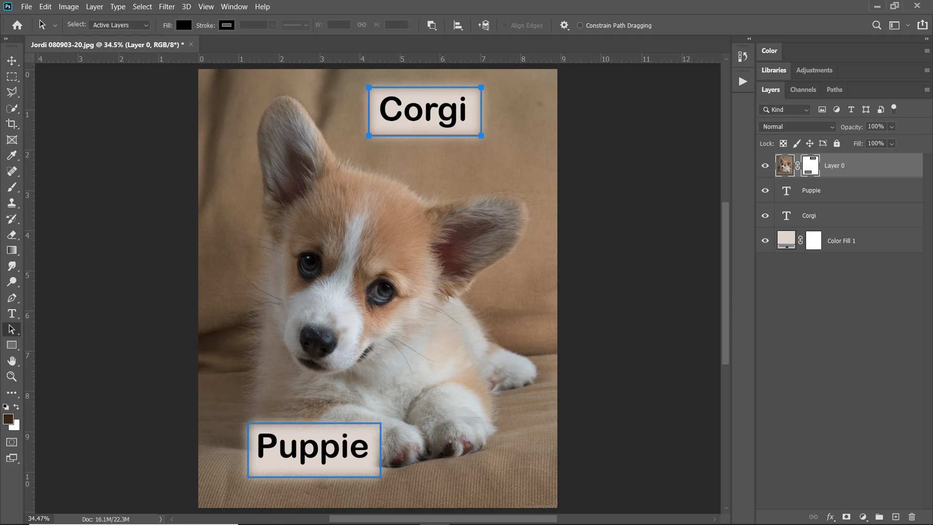

Hi Trevor - Thanks for your reply! It's the "brush tool (B)." I wasn't aware of Quick Mask; that might work, although after a brief attempt at working with it, the edges don't seem to come out the same as when I worked in S&M.
To explain the use (if it makes any difference)...the artwork I'm doing involves masking multiple areas of an image so that specific pieces of text on an underlying area shows through -- sometimes a round brush looks ok, but the square usually looks best, and I had done this on previous works, so that's why I'm really baffled that I can't find it now...

Regards masking images to text, then is definitely easier to use selections rather than clipping?
I either clip the layers directly, or Ctrl click the text layer to load the selection, and add a layer mask to the image layer.  I am struggling to think of an efficient workflow for this that involved Select & Mask.  S&M is for soft irregular edges.  Text is usually about hard edges.
