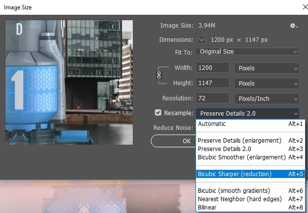

There's not much to it. The downsize option will affect image eventual size.  Bilinear would be a good option, but if you keep the original and work on a copy, you can always go back.
Having downsized the image, Save it as a JPG with a quality setting of 10, and see what the resulting image size is.  If it exceeds 300kb the Save as JPG again, and use a lower quality setting.
Note that JPG compression works better on images with fewer variations on colour.  A solid red will compress to a tiny size, where as a psychedelic mess will save as a much larger file.
[EDIT] Note that my screen shot has Bicubic Sharper highlighted.  Bt all means try that, but it will result in a larger file size than Bilinear.  I also find that Bicubic Sharper is much too harsh and produces an oversharpened end result.
