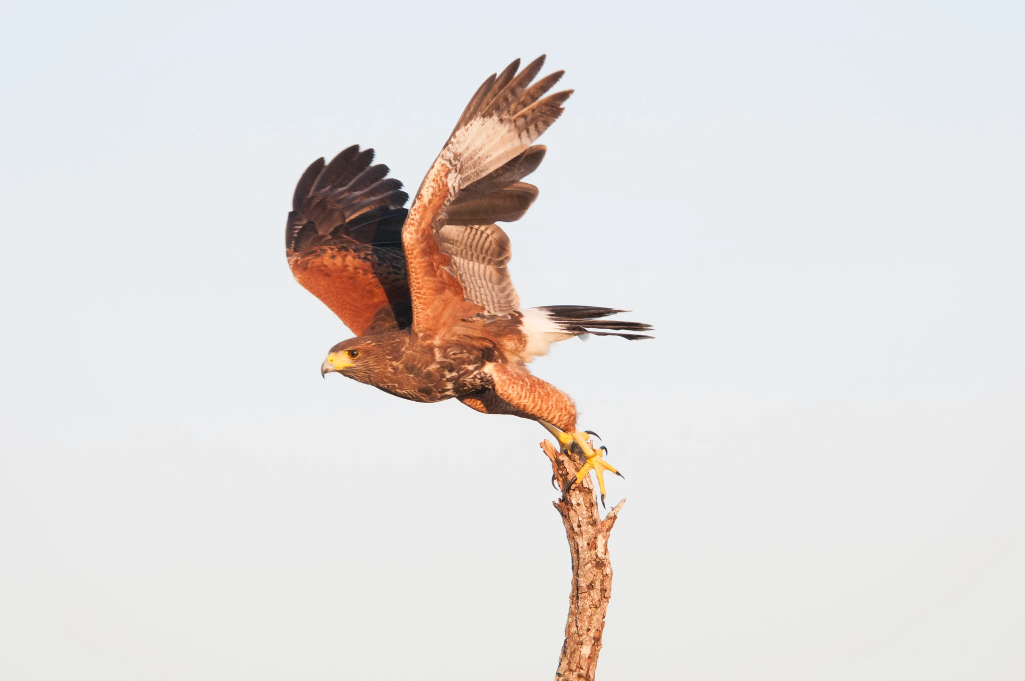

Picture of a bird.  Not a great picture, but one I want to put a blue sky with puffy clouds behind and print large-ish so the selection needs to be good.  Again, I've done this regularly using the previous tools with fairly good results.  Nothing special or that should be particularly difficult (or at least not difficult back in the olden days)...

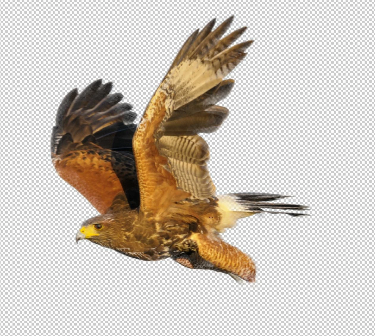

No matter what I do, where I attempt to refine the edge I get a poor selection with background showing through...  Sometimes I get pieces of my selection that are black.  In general, it's just not a very good selection.  Which, since so many people are saying it works fine (and yes, I'm sure it works fine for you, so telling me it works fine isn't useful) it's got to be something I'm doing wrong.......  I've (hopefully) attached a small version of the image, untouched by Lightroom or anything, and a version that shows what a selection I've made looks like as a snip from inside Photoshop...

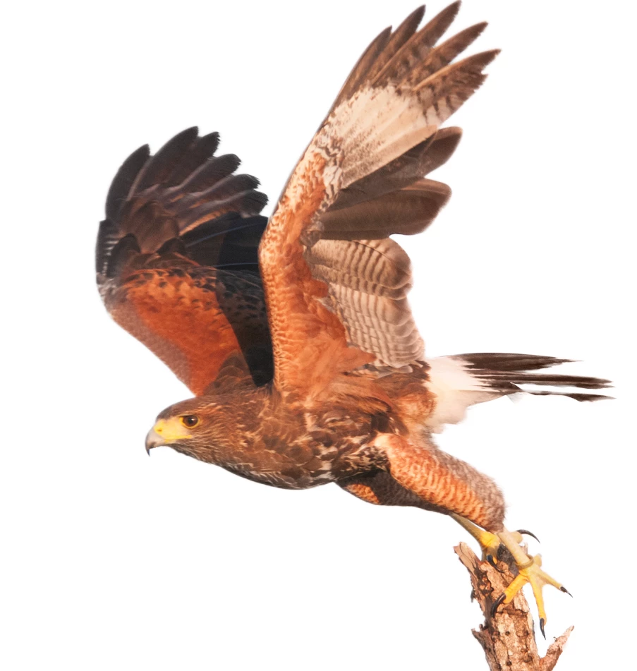

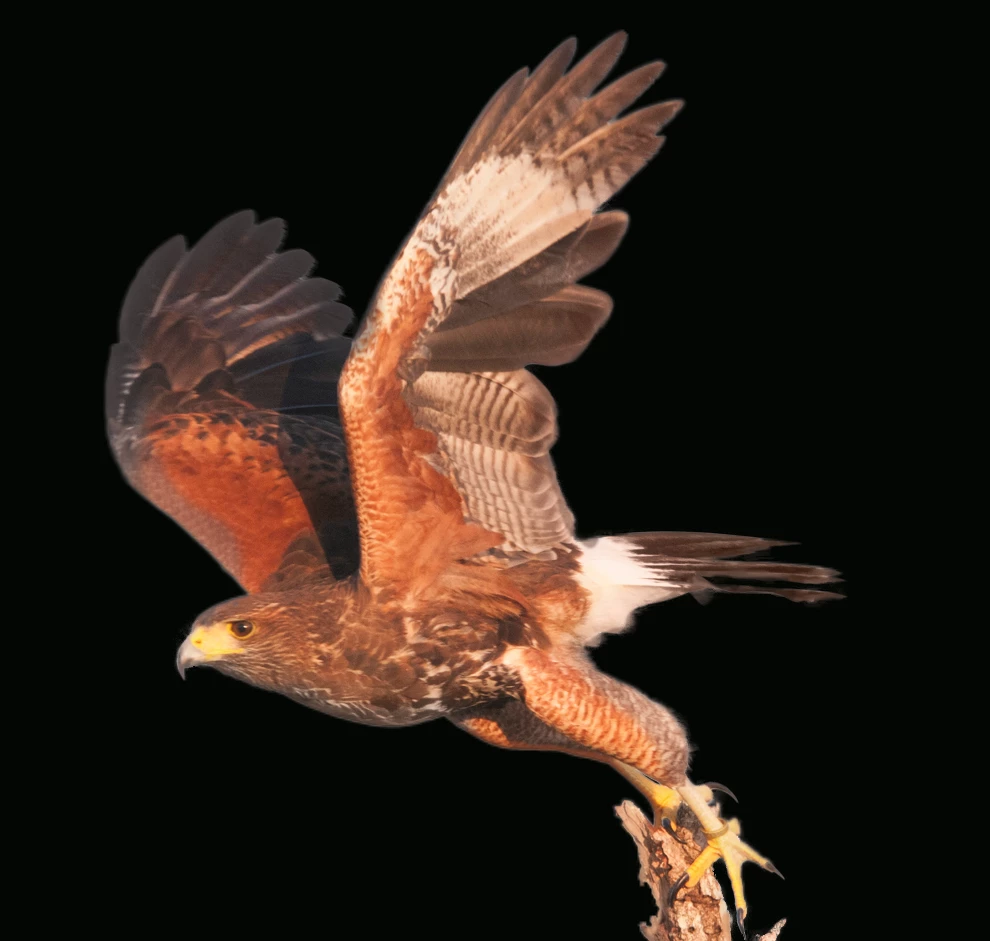

    Here are two examples - both from one mask.

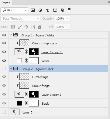

    I used Select and mask and refine edge with the brush at 10px, 100% hardness and 1% space Radius 0px and smart radius off. It took just a few minutes but I ensured that refine edge was only covering edges.
    I did not check decontaminate colours - instead I put a layer above - clipped to the bird layer - set to colour and painted round the edge with the bird colour.
    That was it for the white background. For the black I added a second layer set to luminance and painted the very edges with dark sampled from the bird.
    The layer stack below shows two groups but these are just copies aside from the extra luminance layer for the black background
    Keep refine edge narrow and do your edge colour decontamination separately and you should be fine

    Hi Dave
    Dave

    Hi Dave
    I did the initial selection inside select and mask using the quick selection tool (the top left tool in S&M).
    I try and get the best selection of solid areas using that tool so that refine edge only has to work on the fine edges such as fur/hair or in your case the very edges of the feathers (which is what it is designed to do). That way you only need a small brush.
    I also saw the technique you described with the additional layers in the forum but haven't tried that since it didn't make sense to have to use additional layers to get a decent selection on TOP of the tool that replaced Refine Edge and has been touted so heavily as THE edge selection tool... BUT, I'll go try what you showed and see if it works better.
    The additional layers were not used to make the selection but were used to decontaminate the colours. This is different to refining the edge. In the case of hair for example , even with a perfect selection,  because the edges of hair are semi transparent it is common for a bit of the background colour to show on that properly selected hair.  Select and mask does have a "Decontaminate colours" check box but IMO it does not work anywhere near as well as painting on an additional layer , clipped to the masked image, and set to colour blending mode.
    I hope that helps you
    Dave
