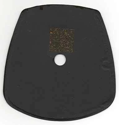

I have a scanned image of something I want to cut out. It has rounded corners. It was not straight on the scanner. I would like to know if there is any method of straightening it in Photoshop? I could also employ Illustrator if that is recommended. Usually, when I have a rectangle-like corner, I use the ruler tool and draw a line. Then I use Image Rotation -> Arbitrary to straighten things. However, I do not have the point to draw my line to and from here. Thanks

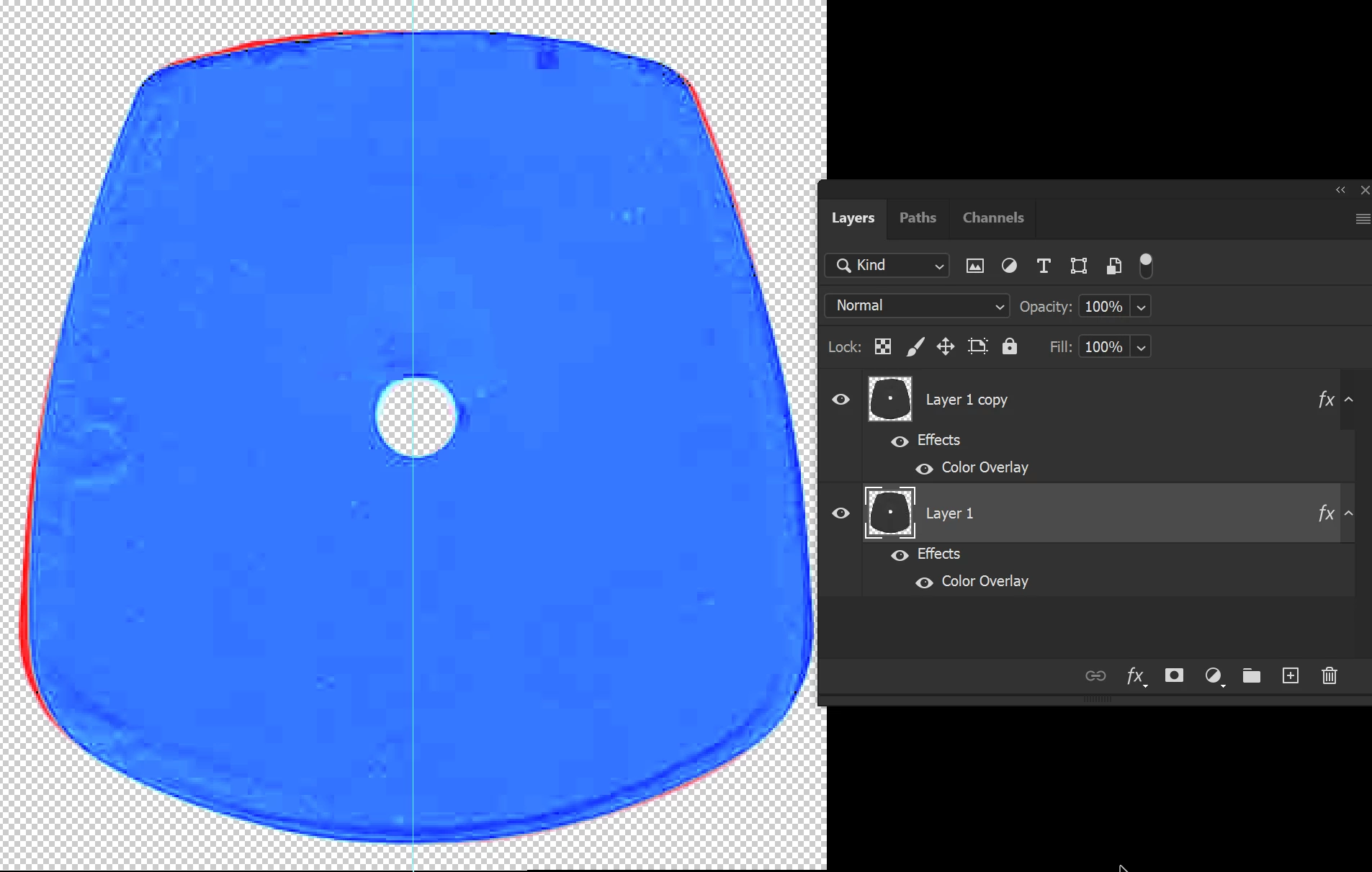

With no straight edges, it seems easier to eyeball it.
However, this is one way:
Duplicate the layer. Flip the top layer (the duplicate) horizontally.
Give each layer a different color overlay effect.
Rotate just the top layer until it aligns with the bottom layer.
You could now delete or hide the top layer.
On the bottom layer, rotate it to a negative half that amount.

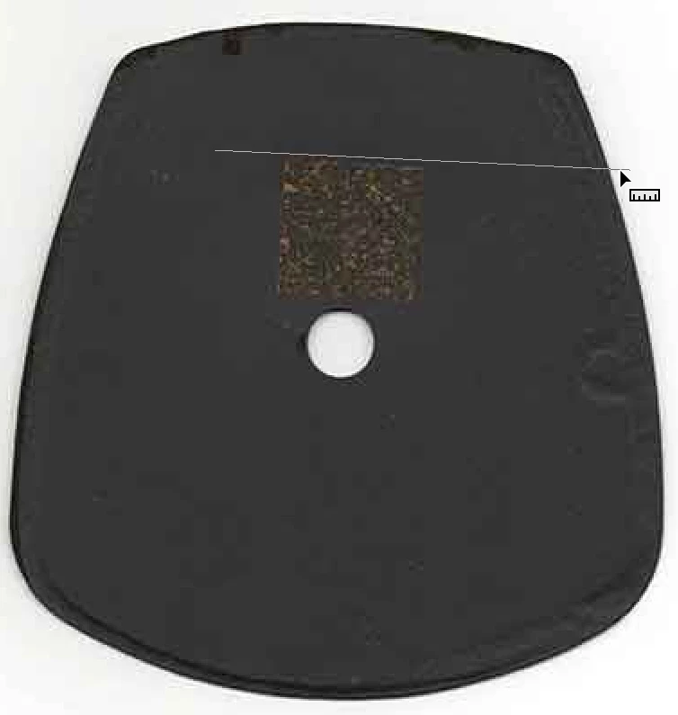

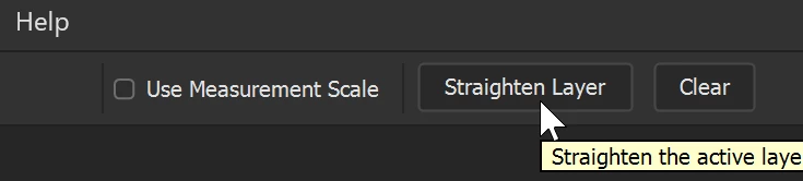

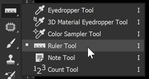

This is one of my favorite ways to straighten:
Select the Ruler tool.
Drag the ruler across a horizontal or vertical. You can adjust the angle by moving the end points after dragging.
Then click on Straighten Layer in the Options bar.

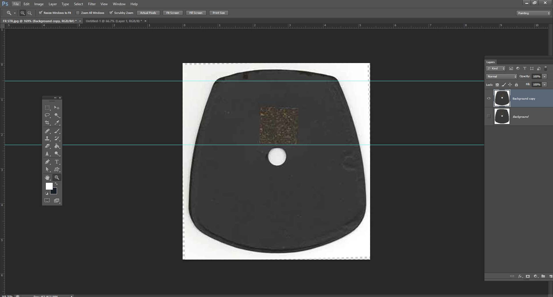

Leslie Moak Murray
June 18, 2022
Drag guides down even with one corner of the square and the right corner of the object, then Edit>Transform>Rotate.
