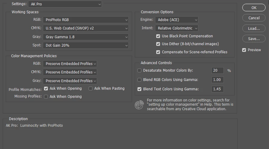

I am trying to send a photo to print and for that i need to convert it to rsg or srgb.
The images, in PS are in Prophoto rgb.
When i use LightRoom to do this, the colors in the exported files are very similar to the ones in PS, which is what i want.
However, when i use PS to export as JPEG, or export and save layercomps, or convert to sRGB/RGB and save as jpeg, i always get wring (washed out) colors.
To which profile should i convert my PS images, which are currently in Prophoto rgb so that they would appear similar when saved as jpeg.
these are my original settings:
which setting should i convert to when i convert to rgb?
I also noticed that if i use PS "Export As" dialog the colors appear fine but i cannot use this since i want to use my scripts which saved the images as rgb.

    Correct answer D Fosse
    karpiyon  wrote
    After opening the file, if I (A) hide the adjustment layer, convert to srgb the colors are preserved correctly.
    When I (B) unhide the adjustment layers and do the same the colors are washed out.
    When I try to flatten the image before converting or play around with the settings, the colors suddenly appear correctly.
    If I then undo try (B) again, suddenly the colors show up correctly.
    This is not a bug. It is in fact expected and normal behavior.
    Adjustments are numerical. A profile conversion changes the numbers. So it follows that all numerical adjustments are color space specific. The same adjustment will produce different effects in different color spaces. Again, this is how it has to be, and this is why Photoshop asks you if you want to flatten before conversion.
    I was about to say "try it for yourself" - but that's just what you did...you just misinterpreted the result.
    BTW, there is no particular advantage in ProPhoto for luminosity masks. A luminosity mask is lifted from a (slightly modified) Lab L channel, and the mask is identical whatever the document color space.
    There are many myths surrounding ProPhoto. One of the most persistent is that it's the "best" color space. It isn't - it's just the largest. But that comes at a price. Increased risk of banding is one, severely compressed shadow values is another. The latter makes subtle shadow adjustments very difficult, because small numerical changes have large effects. It's difficult to use the histogram to spot and correct shadow color casts.
    Routinely using ProPhoto increases the risk of unwanted gamut clipping, because you are forced to deal with it all in one go, at the output stage. Clipping is much easier to control early on. The main use of ProPhoto is to catch and contain raw processor artifacts until you can get them under control, without premature clipping.
    Oh, and BTW - there is no reason whatsoever to "match" Lightroom and Photoshop (or to "synchronize" color settings). These are color managed applications, and any profile, regardless what it is, will be correctly handled. That's the whole point of color management in the first place. That's what it does.

    July 30, 2019
    First of all, don't use Export in Photoshop. It's for web/screen, it's not intended for print. Just Save As.
    Edit > Convert to sRGB, make sure the profile is embedded. Save As to jpeg. That's it.
    That's a misunderstanding. ProPhoto is a very dangerous color space to use if you don't understand the implications, and I've always thought it very strange that it's the default in Lightroom. Defaults are supposed to be fit for beginners - but beginners get in trouble all the time because of this. Those who need ProPhoto will have enough knowledge to find it on their own.
    I'd recommend you stay with sRGB until you get more experience.

    Hi Dan,
    Right off the bat I see your using Relative Colorimetric Rendering intent to go from the largets RGB color space to the smallest.  That clips off colors from the large space going to the smallest and scales neutrals.  Try using Perceptual rendering, I'm sure you will get a more pleasing result.  Also When exporting RGB images always embed the ICC profile.  In your case it's sRGB.  Are you doing that when exporting out of PS?
    Bob
    ICC programmer and developer, Photographer, artist and color management expert, Print standards and process expert.
    Standard RGB working color spaces (sRGB/Adobe RGB/ProPhoto) do not support other intents than Relative Colorimetric. You can choose other intents, but Relative Colorimetric is what you get regardless.

    July 30, 2019
    Interesting and confirmed here...Is this a bug?  Seems a very bizare behaviour For Adobe to include nerfed rendering intents.
