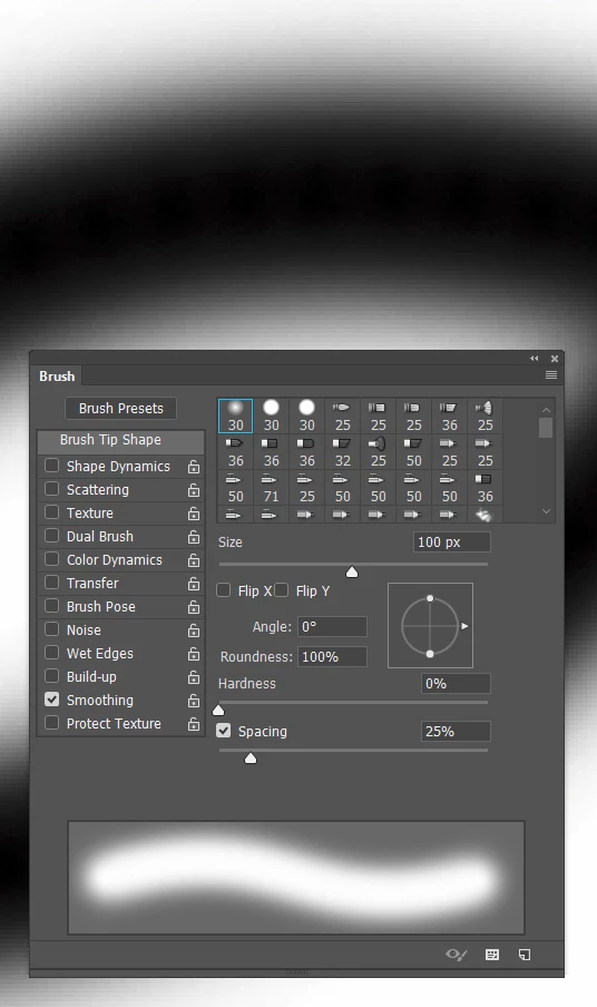

Trevor.Dennis
August 2, 2017
It would have been helpful if you'd had the brush selected in those screen shots as we'd have been able to see its blend mode.  It would have been more helpful to see the brush panel at the same time to ensure that everything but Smoothing was unchecked.  My screen shot is zoomed to 300% the same as yours BTW.
What do you see if you overlap a brush stroke?  Yours has a 'wet edges' look to it.
Try resetting the brush tool as a first step.
JMartenJAuthor
August 2, 2017
Hi
Blend mode is normal, on both brush and layer. As I said, I completely uninstalled photoshop, then installed, opened it and without changing anything, painted those images. The brush tool has been resetted, and the setting looks exactly like yours. The problem only occurs on the transparent backgrounds.
