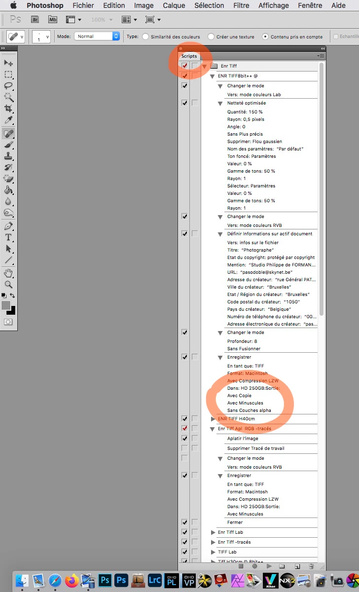

Bonjour,
Je souhaite supprimer les couches alpha d'images tiff dans un script. Je n'avais pas de soucis dans CS5, mais sur CC, je ne trouve pas la méthode.
Correct answer c.pfaffenbichler
That’s an Action; Scripts (as written in JavaScript, VB or AppleScript) are something different, that they share a name in the french version of Photoshop can lead to confusion.
Have you enabled
Photoshop > Preferences > File Handling > Enable legacy "Save As"
Otherwise I guess you might have to re-record that step with File > Save a Copy.

Here is the CS5 Script.
Have you enabled
philipped5581492
February 28, 2022
It seems that it could be the good way...
I will create new "actions" this afternoon.
In any case, thank you very much. I will of course keep you informed of my results. But I also have other work as a priority.
c.pfaffenbichler
February 28, 2022
Pelase post the Script you have been using in CS5.
And just to make sure:
• Script is not equal to Action.
