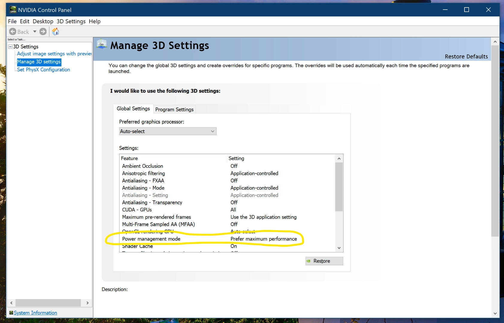

Following others tips has helped me but i feel the nvidia control panel lacking some options will hinder others. So here is step by step what i did to resolve.
Updates latest updates through Windows.
Used ddu (display driver uninstaller)
Updated again through windows updates
Went to nvidias website for latest grd (game ready driver). I allowed it to install GeForce experience
Restarted pc
Right click for nvidia control panel
Bam, then i had the manage 3d settings and it had the option to change power management mode. I told it to prefer maximum performance and now my Photoshop works just fine.
I know some of these steps are redundant but i shared them anyway in the exact way I did it just incase it helps.

July 5, 2019
Temporary work around is to open the nVidia control panel and set the Power management mode to Prefer Max performance.  When I first made the change I got a blue screen but since the reboot, no crashes even when running all Adobe apps together while doing video editing to stress things out.

Applied the now Officially available 1903 Update to my SB2 and again it wouldn't budge even with Photoshop CC running the latest Updates so I immediately went back to 1809 ( actually a matter of less than 5min - that was welcome news to me ) when I read your and clardys replies to report my disappointing findings so I applied the 1903 Update again to check if it would indeed affect F360 as well - which it did - and if the Power Performance change would fix it - which it did.
So yea... Kinda satisfied now that all my Systems are now running the latest Windows version again.
