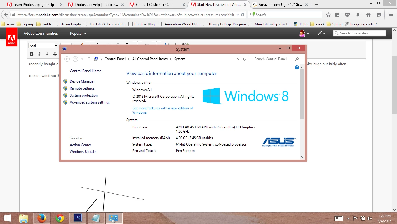

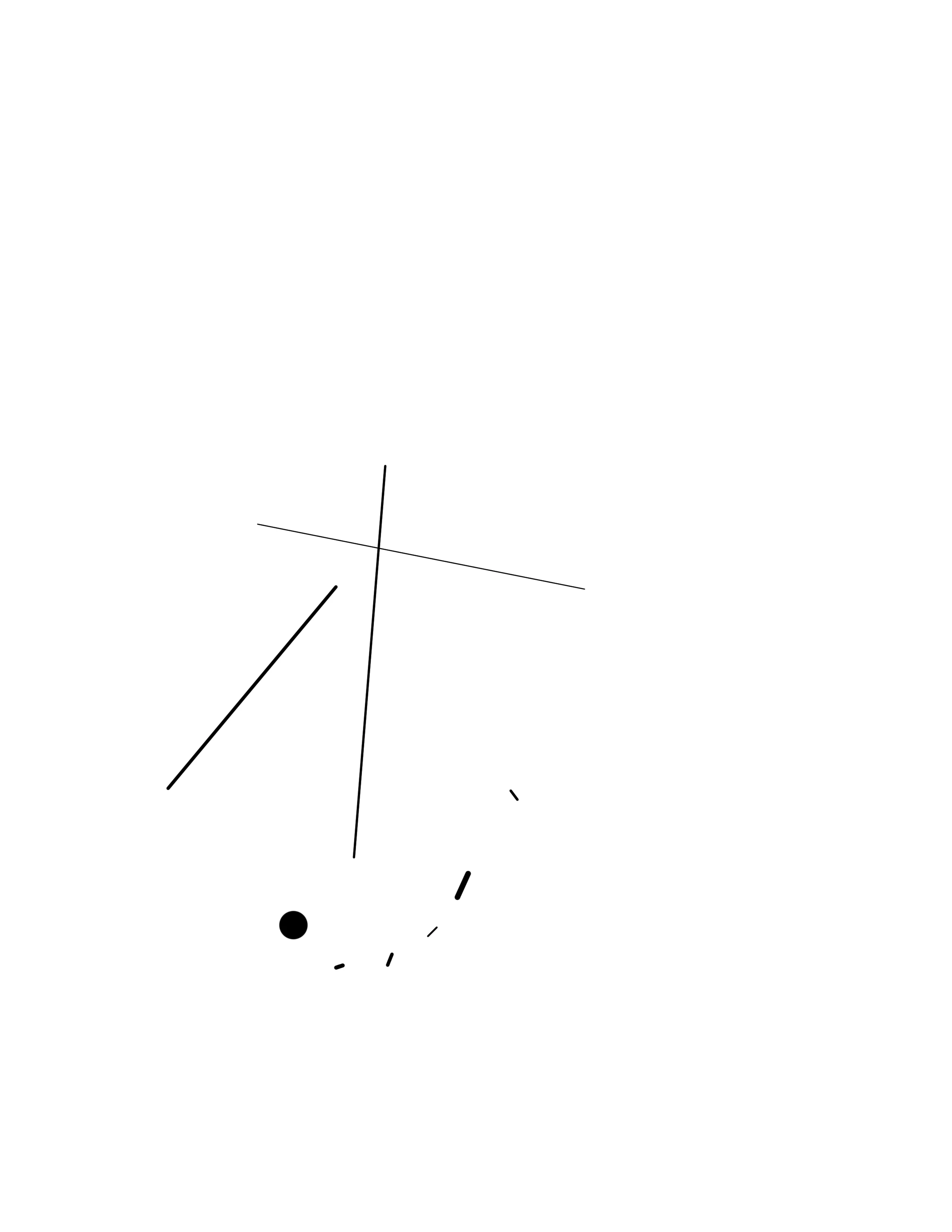

recently bought a ugee 1910b tablet. Really good tablet, less expensive than a cintiq or something. It works fine with sketchbook pro, but in CS6 the pressure sensitivity bugs out fairly often.
the pressure sensitivity works, i've tested it through the proprietary ugee driver software. In cs6 it draws straight lines starting from where I first put my pen down and terminating at where I pick it up.
This is a very frustrating issue, as I'm very excited to start using my tablet. Any help would be appreciated. Please ask me for any more info I might have not mentioned.
specs:

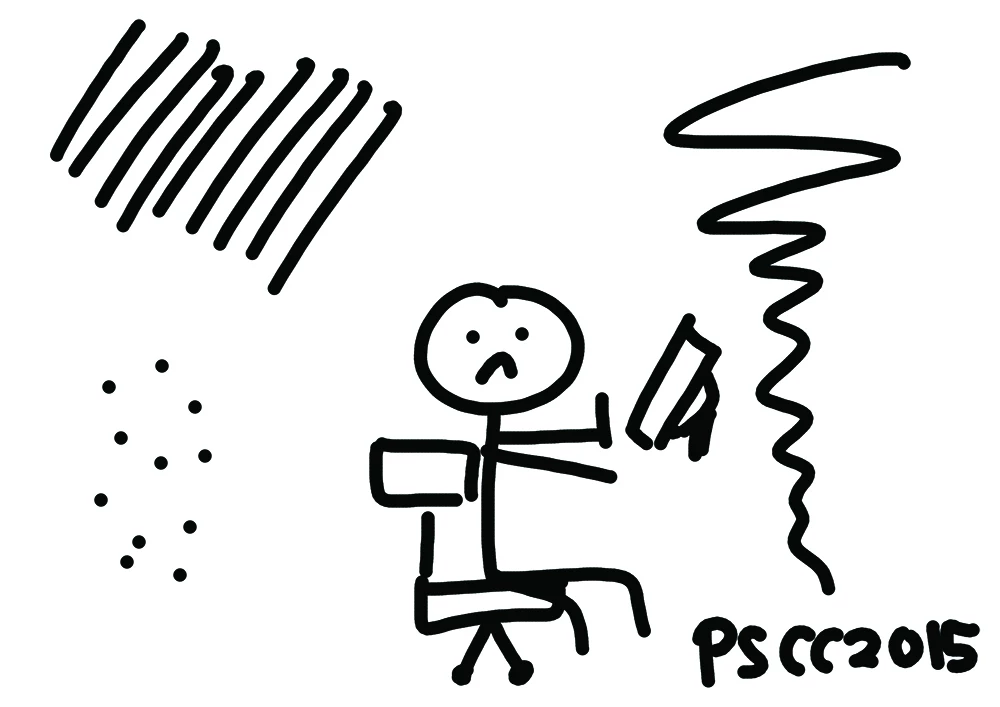

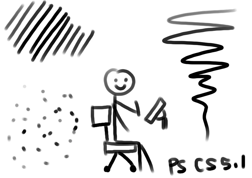

    I was about to make a new thread but apparently this needs more attention since ugee tablet users are underrated.
    Im using a tablet UGEE 1910B where the pen pressure does NOT Work ONLY in Photoshop cc 2015. I was a Photoshop CS5.1 user before deciding to use the "latest" version of photoshop. I am very disappointed to this factor and considering to reinstall Photoshop 7 to make this "trendiest" version any more useful. This isnt tablet's fault and If you needs more evidences I can submit files from MS Paint or Gimp.

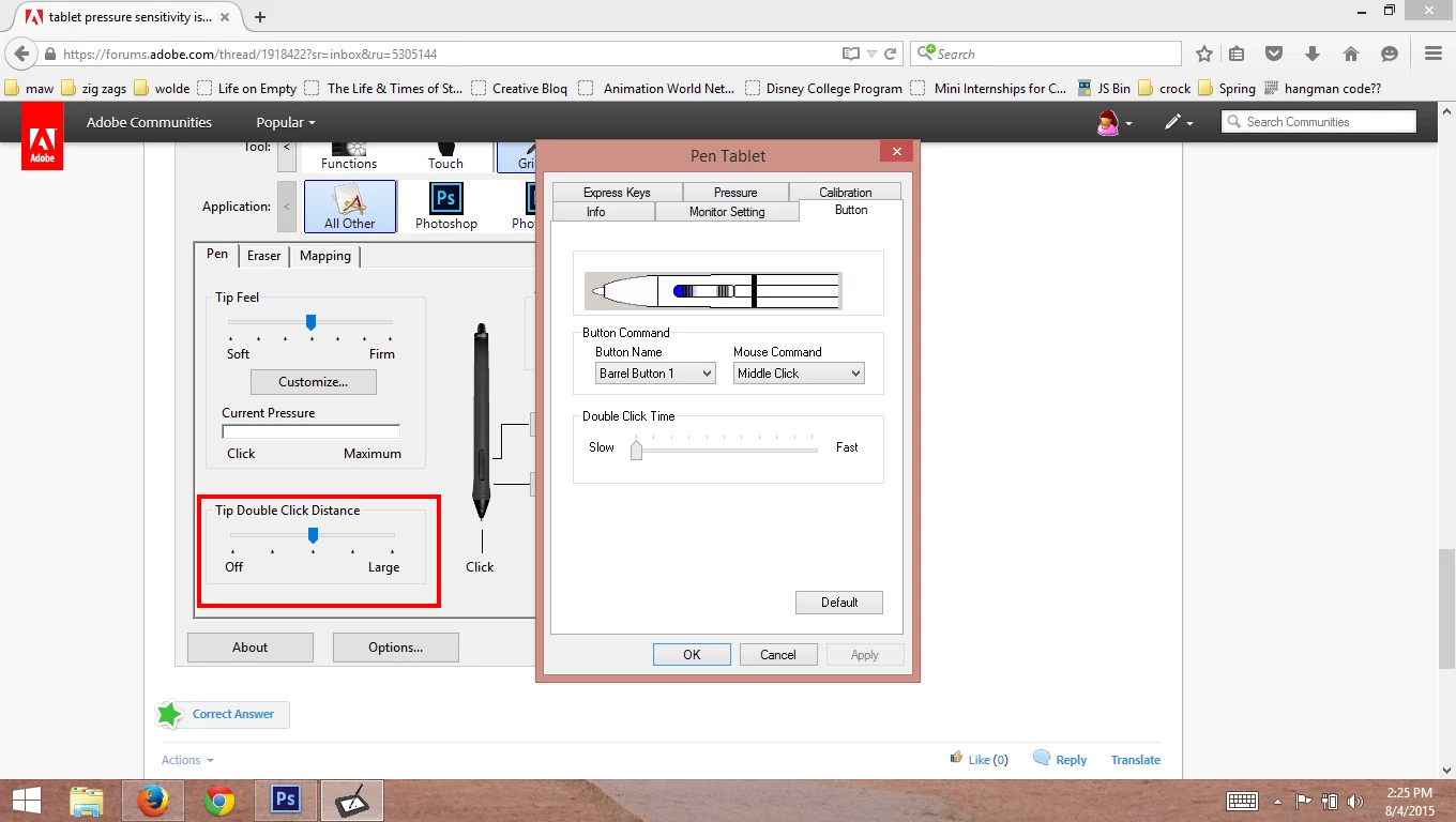

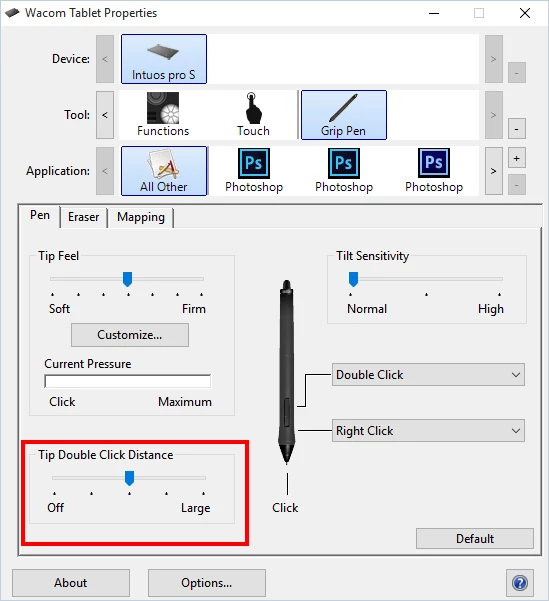

    JJMack
    August 4, 2015
    Seem to remember I reading that some Wacom users were having problems like that also.  The solution for them was to turn off the Wacom Pen tip Double Click Distance setting.  Does your tablets pen driver have a similar setting???
    JJMack
    snickerwicket
    August 4, 2015
    thanks for the reply, no that hasn't seemed to have fixed the issue. Doesn't look like there's an "off" option anyhow
