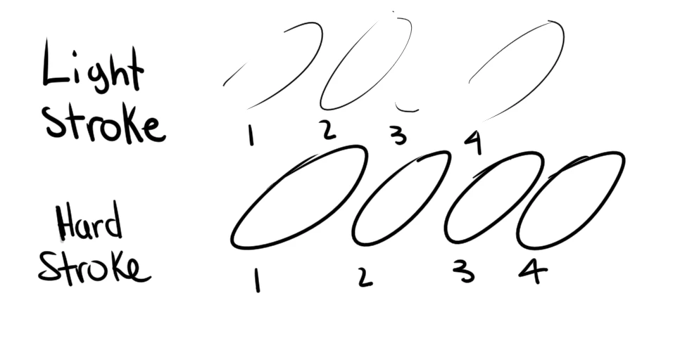

My tablet seems to skip strokes when I do light strokes. If I would for example draw a circle by quickly and lightly making a circular gesture, nothing or just a part of the circle would be drawn.
Note that the problem does not occur when I do hard strokes where I put medium pressure on my pen. Also, the problem seems to randomly occur; sometimes the circle would be drawn sometimes not, sometimes partially. Here's an example:

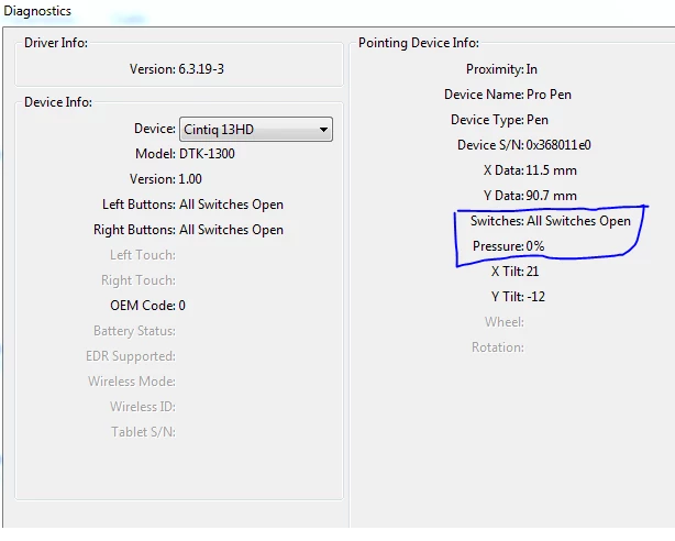

I've gone into the Tablet Diagnostic thingy, in Tablet Proprieties and have noticed that it says that 0% pressure is applied and that ''All Switches are open'' when I'm clearly putting pressure as I would normally do to click on something or draw. Here's what im talking about :

I recently started getting this issue on my ~8 year old Cintiq 22 hd (and pen). Fortunatly I have another wacom tablet with its own pen and when I tried using it on my Cintiq 22, it worked without issue. I also tried my Cintiq 22's pen on my other tablet and my strokes started to skip. Confirming that it was a problem with my pen and not the device. Hope this helps!

I set the "tip feel" to a notch softer, and the "tip double click distance" a notch towards "off" and that seemed to help a little, but the pen is still dropping out randomly in between and during strokes. I was starting to wonder if it's the pen itself that's starting to break so I grabbed my other pen (for cintiq companion) and it seemed to immediately fix the problem. Tested the two pens on the same canvas in paint tool sai.
Not going to lie, I have dropped my pen quite a few times, I always wondered if the little mechanics in the pen would be damaged, and it finally seems like that is the case. It would be an expensive thing to test, but if you're still having the issue and suspect the pen has been dropped or banged around enough, it may be time to dish out for a new one...
