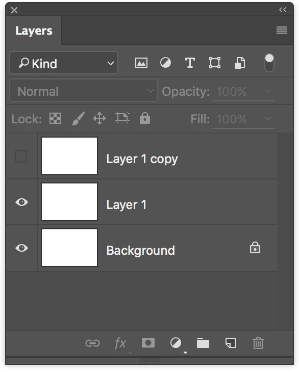

this is probably so easy that I can't see it. Simple document:
Simple script that loops through layers and deletes the one that's hidden:
var doc = app.activeDocument;
for (var i = 0; i < doc.artLayers.length; i++) {
    if (!doc.artLayers.visible) {
        doc.artLayers.remove();
There are better ways I know, but it works.

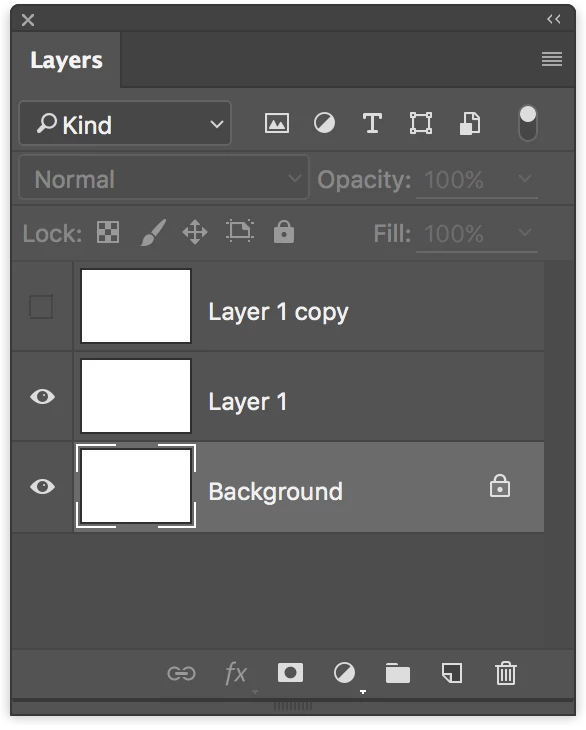

Now try this as a starting point (no layers actually selected):
The above script fails with error "The Command Delete is not currently available".
I've added an extra line to make it active, but it doesn't (at least Photoshop CC2015.5, OSX)
