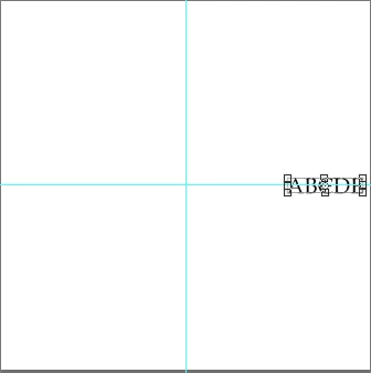

Start with your first line of text snapped to a guide.

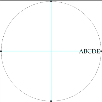

Use the elliptical shape tool to create a circle (drawn out from the centre)

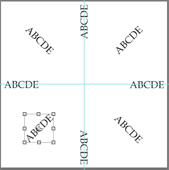

Duplicate your text layer (however many times you need - I've used 7 duplicates below to give 45 degree text)

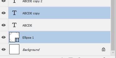

Select the ellipse layer and the first duplicate and choose the move tool. The bounding box handles for the move tool will surround the entire circle and the rotation will be in the centre of the ellipse, i.e. the point from which you pulled the circle originally)
Rotate the handles by the required amount (in my case 45 degrees). Both the text and the shape rotate together.
Repeat for the other layers (each time selecting one text layer and the circular shape layer)
Finally flip the text on the layers as required (in this case those showing text on the left side)
