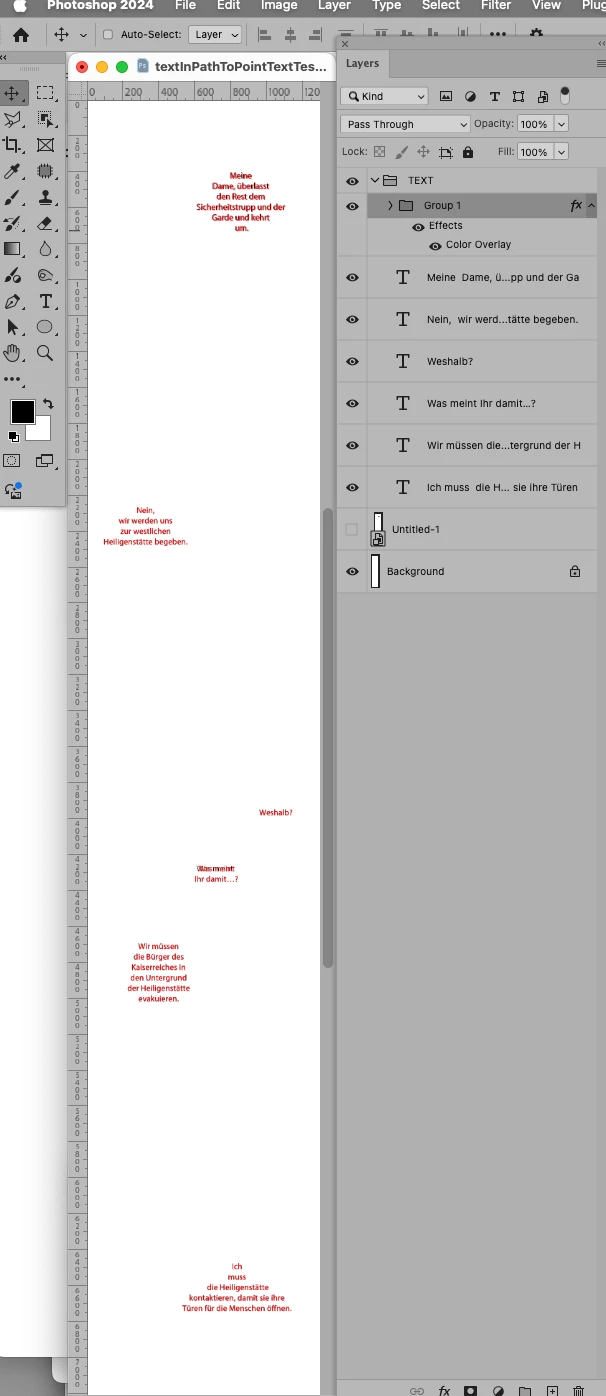

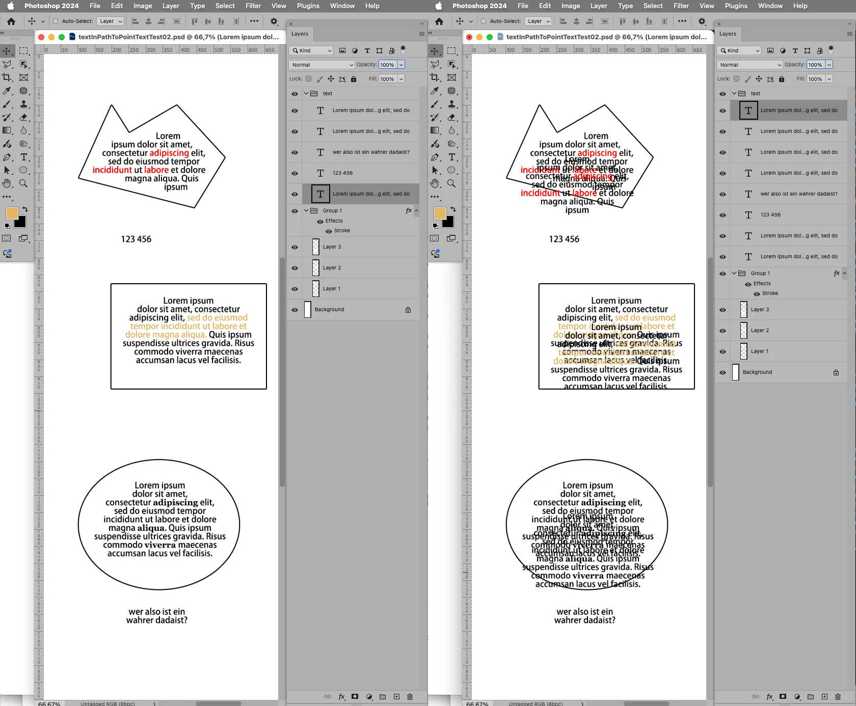

Thank to many helps from this forum that now I could improve all my works! Now I have a new trouble about typing inside the shape/path. As y'all know, the path text is very awesome for typing inside shapes, but it could never be turned into point text (or paragraph text, of course haha).
My first solution is: breaking lines of the text by continuing press end > enter until the last line, then copy the whole content into a new point text layer. However, there are so many text layers now, that I could not done by hand anymore! I tried auto keyboard but not very effective, now I need a solution as a script or action. Is it possible in photoshop? I've attached the sample file, thank you very much for taking an attention to this post!
Correct answer c.pfaffenbichler
oh... So that's because of my additional line break?

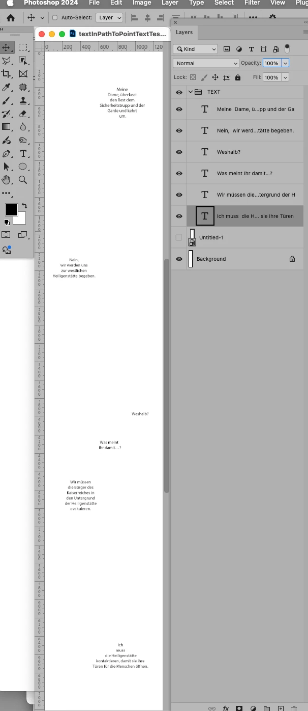

August 2, 2024
Thank you so very much!!! You really save my whole life 😄
c.pfaffenbichler
July 31, 2024
I updated the previous code.
July 31, 2024
Thank you very much!! The script worked exact what I need, although a bit slow (may due to my device XD) and only run one layer a time. I wonder if I do the 'converting text layer to path' step - separate with your script, will the script run faster?

Why do you want to turn it into Point Text?
For the top example (with the irregular shape) the alignment and line-breaks would get lost.
July 31, 2024
Actually in my work, the alignment of the shape is not so important, we need the text just be at the center of the shape, most of them will be round or rectangular ( the top one I just drawn is a random one, but it was so distort haha, pls forget about it)
The Point text is one of our required task. When we haven't found out the Path text, we broke the line by feelings (it means keep pressing enter, and delete, and enter, delete until the text looks fine, that thing wasted almost time). I wished they would keep working with Path text, but they don't want to 😞
c.pfaffenbichler
July 31, 2024

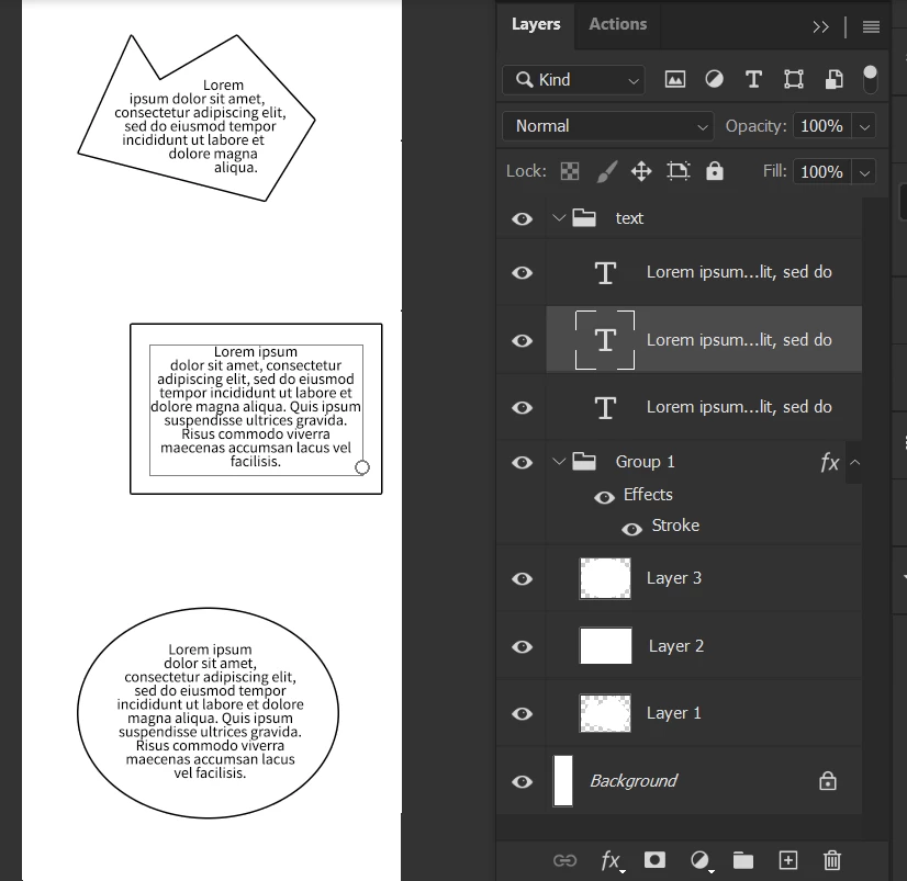

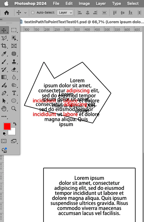

I don’t understand what the point is. Could you please post screenshots to clarify?
Does this help? (I colored some words to ascertain whether type settings are honored.)
Edit: The Script works on the active Layer and does not include a check for Type-in-Path so far but depends on a fitting Layer to be selected.
