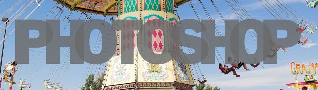

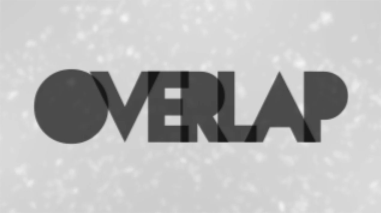

I'm working on a photoshop text that overlaps and fades into each other but you can see them mix and be darker where they overlap.
I've been able to do this in the past with just lowering down the opacity of the text no problem. However, for some reason, the text is not blending like it should.
The first image is what I created in After Effects.

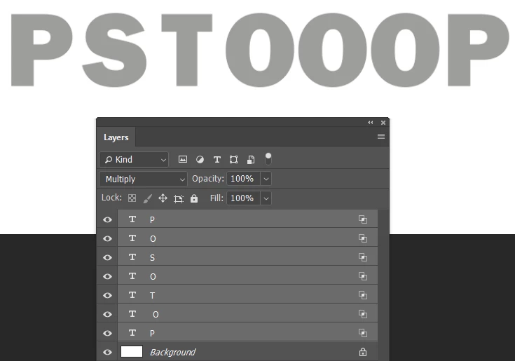

This second image is from Photoshop.
How can I fix this?

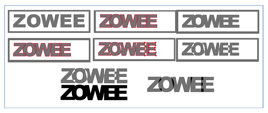

    Open a file a type a word (Fig. 1)
    Choose Type > Convert to Shape
    Click in a clear area wit\ the Path Selection tool then click on the first letter to be moved
    Use the keyboard arrows to slide the letter left to overlap. Repeat with the other letters (Fig 2)
    When completed, click on the Path Selection tool again
    Duplicate the layer
    Turn off the top.layer and return to the layers below it
    Still working with the Path Selection tool,
    In the Options bar choose hold down the overlapping boxes and choose Merge Shape Components
    Choose Edit > Define Custom Shape (Fig 3)
    Turn off the layer
    Return to the top layer (Fig 4)
    Click ion the first moved letter, go to the overlapping boxes and choose Exclude Overlapping Shapes
    Repeat for each of the other letters that had been moved (Fig 5)
    Finally choose Merge Shape Components from the overlapping boxes again
    Click on the Path Selection\ tool again so the control points are visible
    Choose Edit > Define Custom Shape (Fig 6)
    Open a new file and draw the two Shapes. Apply Edit > Transform refine register  (Fig 7 & 8)

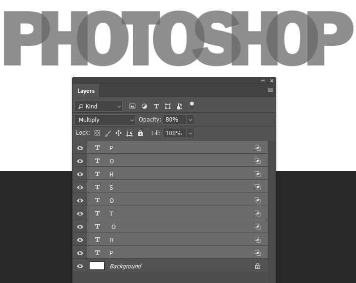

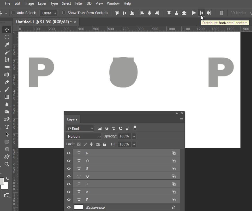

    I can't think of any way of doing that other than having each letter on a separate Type layer.  It sounds like a lot of messing about, but it is not actually too much trouble if you know a trick or two
    One thing I learned while setting this up is that you can't simply make the first letter and copy it eight times, and then edit each letter, but I'll come back to that.

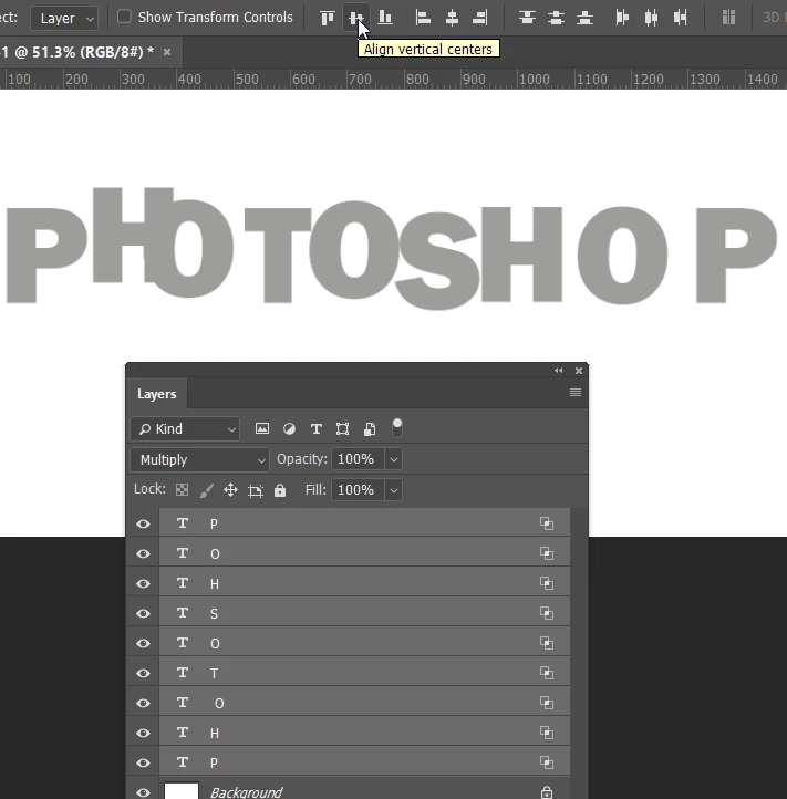

    So have made your nine Type layers, move the first and last characters into position, select the Move tool. Select all the type layers and use the align tool.  This is where I ran into trouble because some characters are wider than others, and that affected the order they were distributed in to.
    Like this
    So you then need to select the Move tool, and make sure that Auto Select is unchecked, and is set to Layer
    Now Ctrl click on each character and move into position.  You can hold down the Shift key to keep the vertical alignment, but then ends up making you select multiple layers, so don't worry too much about that.  Whoops, I have missed out the H characters.
    If you need room to spread them out, select the Type tool and all the type layers, and change the size. Tab away from the size field, and all the layers will resize together.

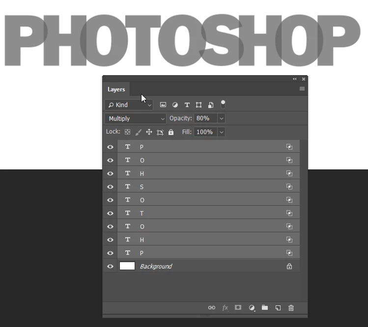

    If you end up with something like this,m select all the layers again and the Move tool, and click on Align Vertical centres
    Increase the character size again to give you the overlap.  Remember, select the Type tool, all the type layers, and change the size.
    Having achieved the right degree of overlap, reduce opacity and change the colour to suite.  Here again, so long as the Type tool and all the type layers are selected, you can do both of those operations in one go.  Note you do not need to change the blend mode.  I set Multiply at the start, but I changed it to normal with no change to ho it looked.

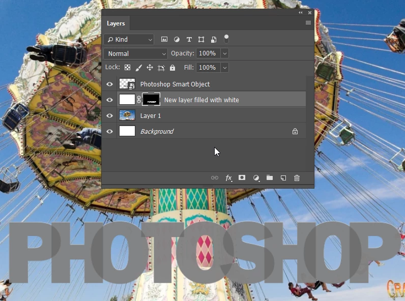

    When you have the look you want, maybe make the type layers into a single Smart Object, and Free Transform to the size you need.  At any time you can double click the SO to edit it.  Remember if you want to make the SO wider, you'll need to add canvas in the new window the SO opens for editing.
    Does the reduced opacity present any problems?
    If it does, add a layer underneath the SO and fill with white.  Ctrl click the SO to load it as a selection, and add a layer mask to the white layer

    Try using a Multiply Blend mode for each layer in Photoshop, then mess with the opacities. That might help.
