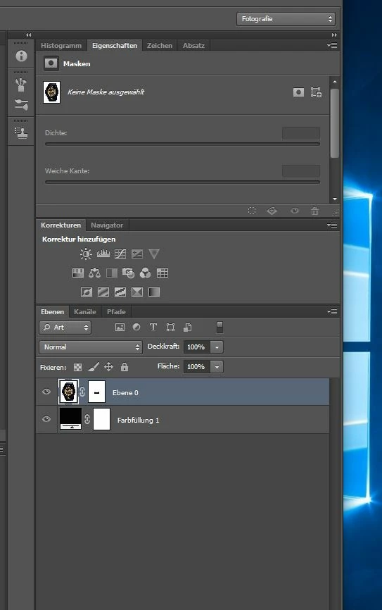

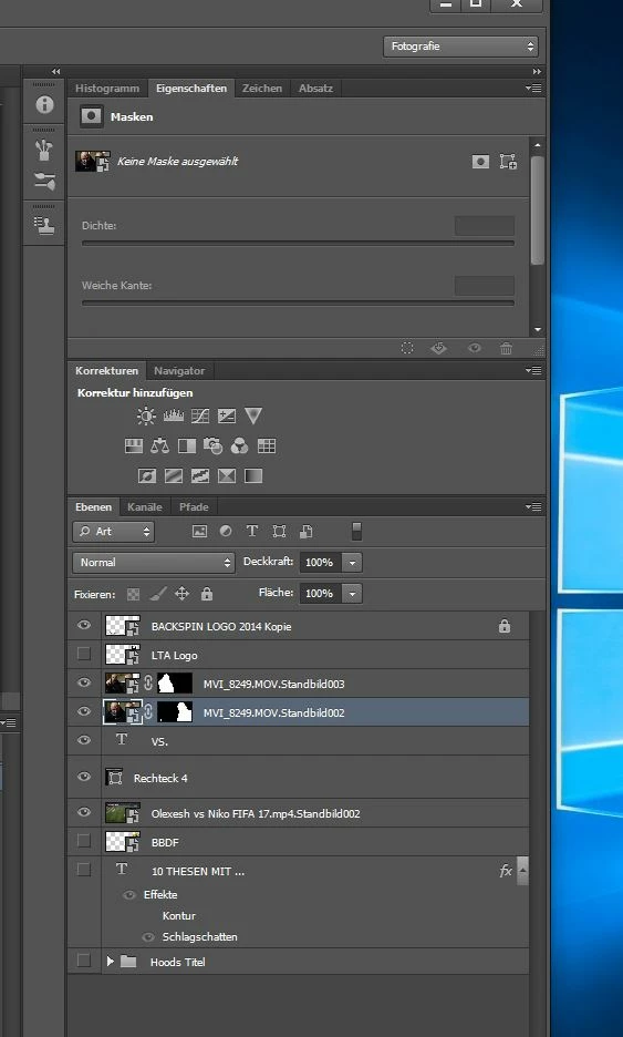

Hello, yes I tried restarting and resetting bout nothing helped. Here a 2 Pictures of my layers panel:
