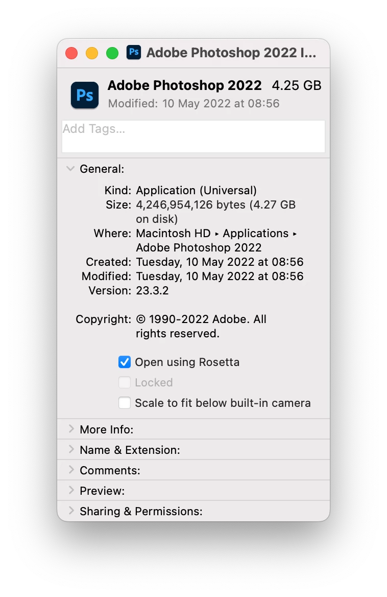

Photoshop on M1 doesn't support video unless run under Rosetta. So that's the ONLY way it will work.
June 8, 2022
Apologies, got the terminology the wrong way round... it used to be 'Render Image Sequence' but in Photoshop 2022 it's now referred to as 'Render Video'...
June 8, 2022
I'm edging closer to the solution... Opening Photoshop 2022 using Rosetta seems to fix the problem, although I'm going to keep digging to find a solution without having to enable it! :-S
June 9, 2022
So after a bit more research, I was initially correct after all... 'Render Image Sequence' is currently used on Photoshop 2022. However, when opening Photoshop 2022 using Rosetta, it reverts it back to the old terminology, 'Render Video', hence why the script only works when it's running in Rosetta!
