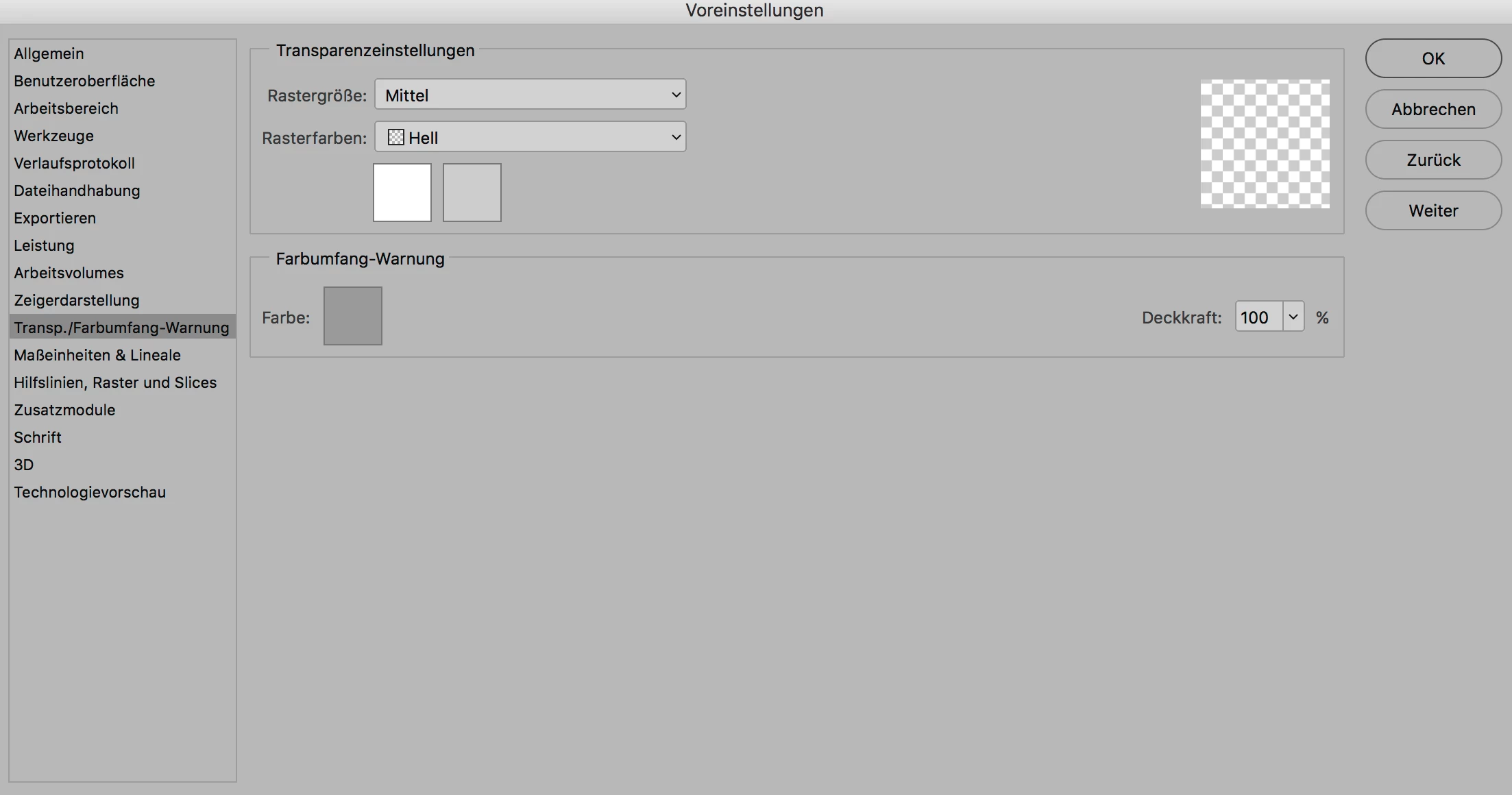

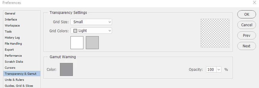

Have you checked the setting of  Preferences - Transparency and Gamut - Gamut warning and selected the colour and opacity
This selects the colour for use when View Gamut warning is checked
The warning shows what is out of gamut in the space set in "proof set up". If your image mode is the same as the proof set up you will not see a warning as, by definition the image colours are in gamut.

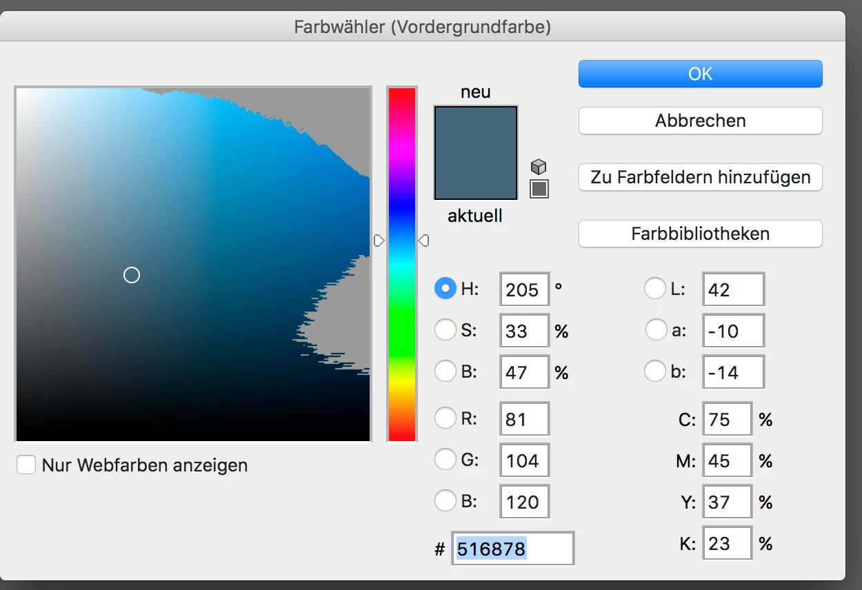

First off, thanks for your responses. I have always relied on the gamut warnings when drawing in psd. I am on Photoshop CC2017. Up until a few days ago the color picker greyed out the colors which were out of the gamut range. Because I can't show you how it looked a few days ago, I am adding a screenshot of how it looks in CS6:
This is also how it appeared in my current psd up until a few days ago.

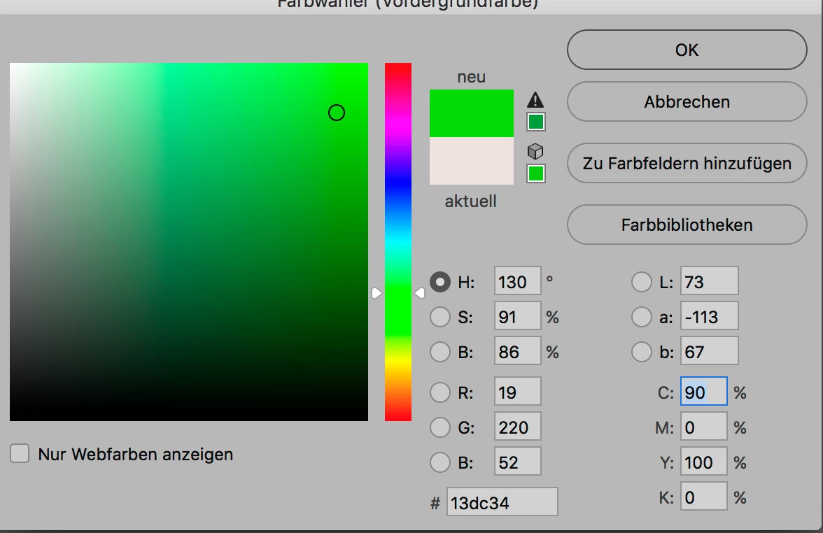

Now the greyed out area is missing. Maybe I am overlooking something in one of the panels—a box to check or something. I would like the following to look like the color picker above.
Mind you, I do have the gamut warning turned on and I draw in proof modus. Although it might seem like a slight inconvenience to some, because the warning triangle is shown, the missing 'out-of-gamut' range that you see in the first image has been an extremely helpful tool for me.
How can I get that back?
Thanks.
ps Davescm: My preference pane is set up just as yours is and I have the Gamut warning und View checked.

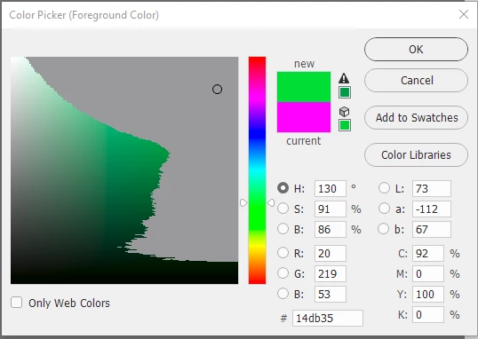

You have to check Gamut warning with the Color Picker open. Then you see this :
If you have those same settings then all I can suggest is reset the preferences and see if that clears your issue.
