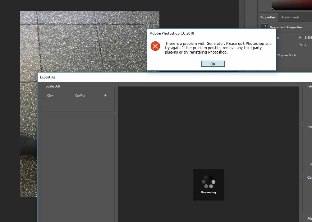

Hi
I have searched Adobe support sites and tried every solution possible (I think).  Stil got the error message during startup, when I try to export (Both Export As.. and Quick export as PNG/JPG). Uninstalled photoshop, rebooted, reinstalled photoshop, deleted all my plug-ins  (Only from One.com) deleted preferences, resett photoshop  (Ctrl+Alt+Shift during start) and so on.
Now I need som help to get this issue solved.  Can someone please help me?
