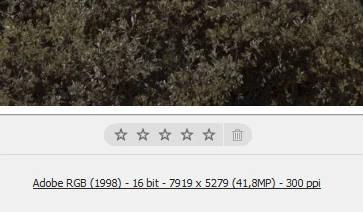

They are 16 bit - I sample my new files in Adobe Bridge first and select the images I want to work on in Photoshop.
The only thing that is different is the versions of Bridge and Photoshop have changed.
Thanks
