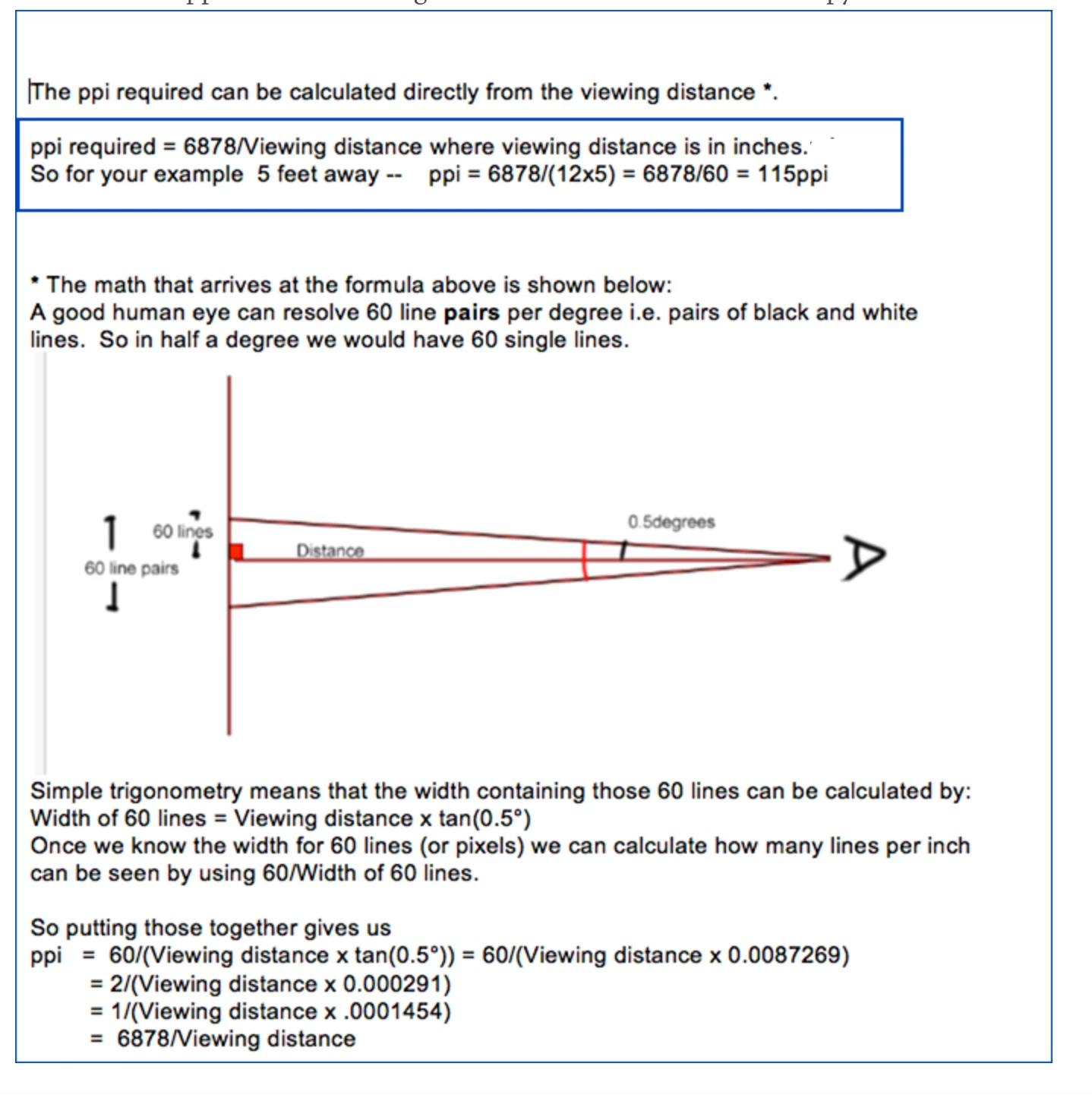

@D Fosse nails it. He always does.
For more evidence, refer to the following which was contributed by @davescm some time ago.
It is a treasure, and so is Dave.

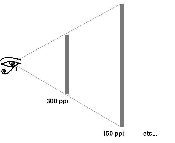

March 31, 2021
I'm sure someone told you that you need to do this at 300 ppi. Which is nonsense.
You don't need more pixels just because it's printed in a large format. Any good file will work for anything, whether it's a magazine spread or a large billboard. You don't need a huge file, you just need a good one. Anywhere between, say, 50-70 ppi will look absolutely spectacular at these sizes. That translates to a file of around 6000-7000 pixels long side, which is what you get from a good camera nowadays.
The bigger it is, the lower the ppi requirement, because it will be seen from farther away. Here's how that works:
