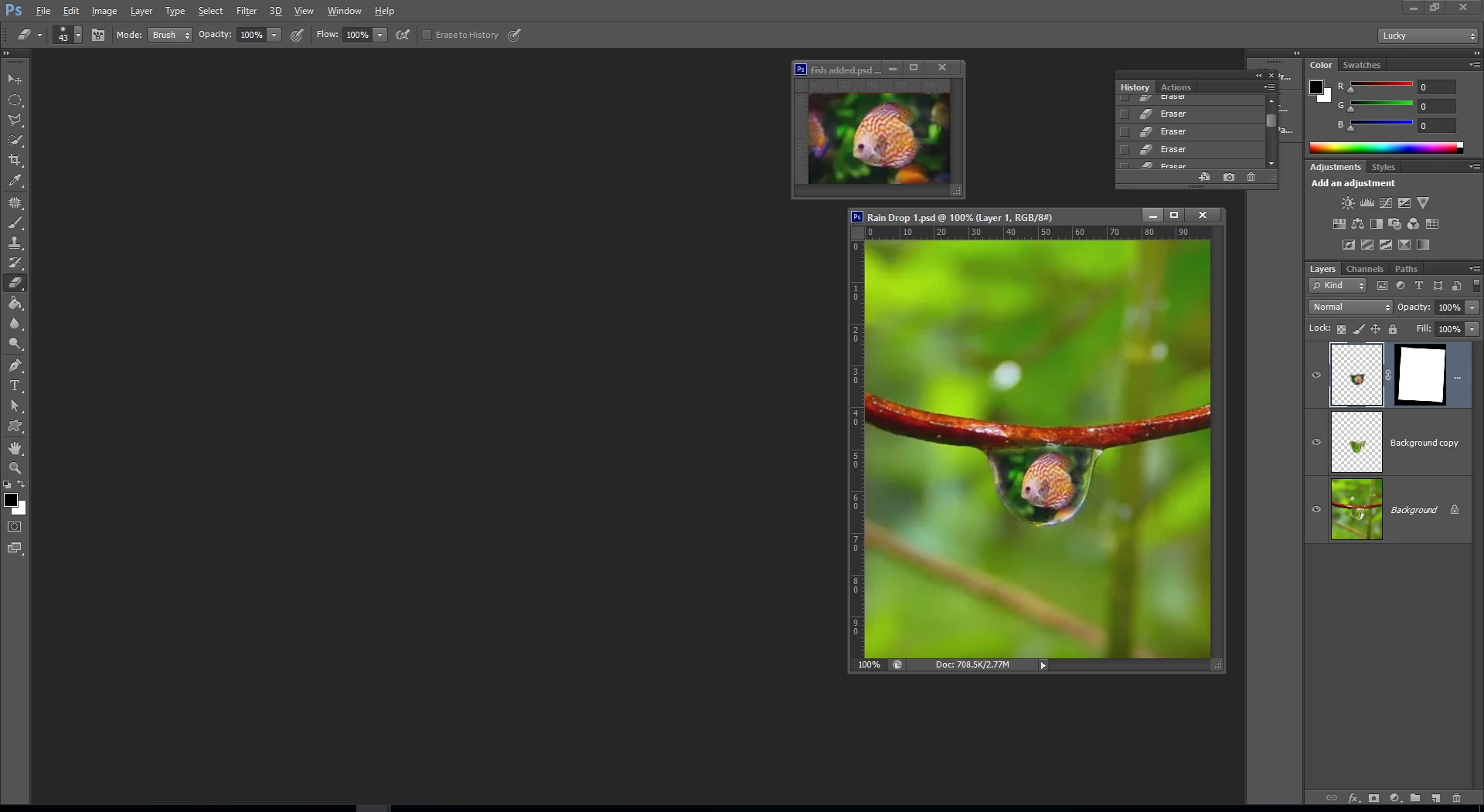

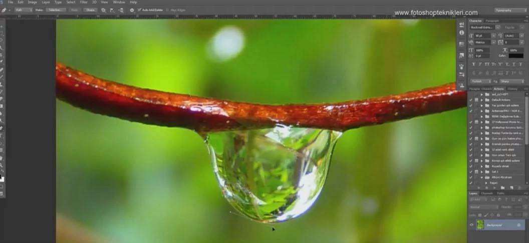

I should know how this is done as I have opened a transform with the crossbars in an earlier tutorial--didn't write down how I did it. I want to put the fish into the raindrop. The tutorial for this is very fast, not very clear, and no transcript. I think I will be needing a lot of help along the way. Thanks for looking, Lucie.

August 15, 2017
I opened the fish in its own document as you stated above, it worked just as you said. But, I noticed in the tutorial that the background was included along with the fish so I created the layer mask and dragged the fish over (I think that's what I did, I won't know until I try it again). Then I did the CTRL/T and matched how it was in the tutorial. Then I erased around until the raindrop with the fish appeared. I can't seem to control the mouse so it erases all over the place!
