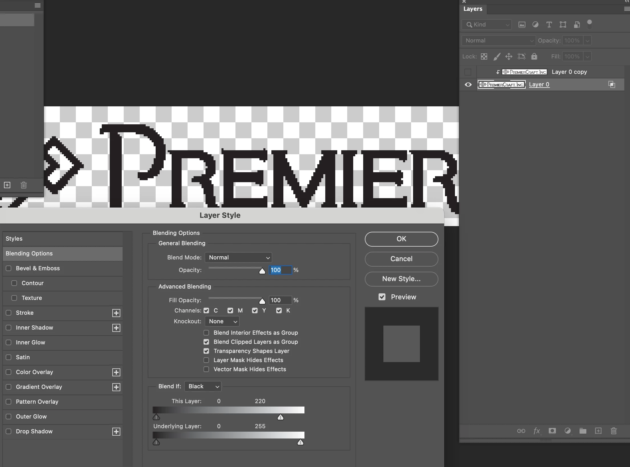

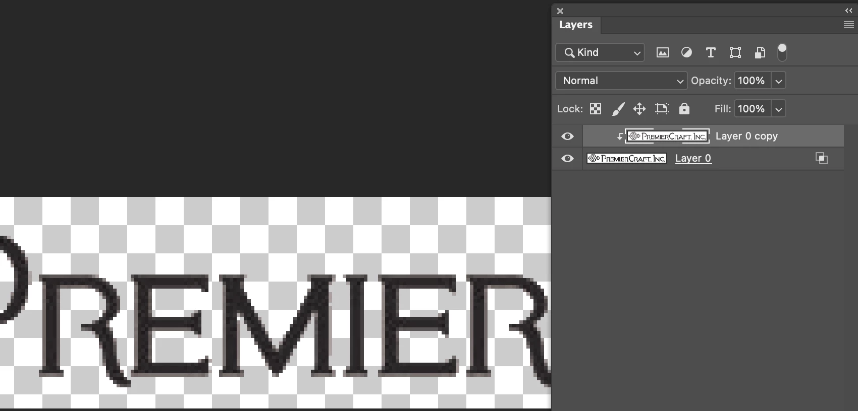

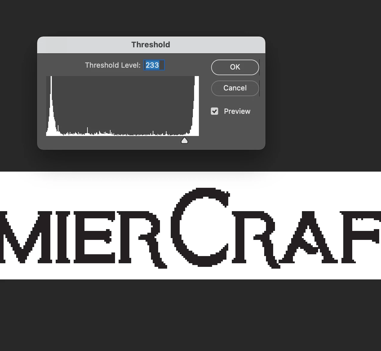

Make a duplicate layer and use threshold to make it solid black and to remove the jpg artifacts on that layer.
Use the Blend if slider in layer options to remove the (now solid) white area
With the orginal logo on top, option-click between the layers
This effectively makes the solid-black-and-transparent layer into a mask for the original layer.
