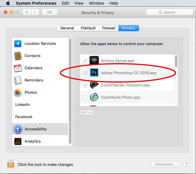

When Photoshop runs a batch process, it runs a JavaScript. I assume that this means that Photoshop needs to have permission to control your Mac. Check this setting.
-- Johan W. Elzenga

That seemed promising for a moment, because I was able to do a batch action to save to DataPartion/Documents, but still not reproducibly save to whatever folder I want.
But I think I have solved the problem:  I had two folders named Documents, one on BootDrive, and one on one on DataPartition.  Mac OS was confounding the two folders after the rebuild; I was able to navigate around it, but Photoshop was not.
I renamed the Documents folder on DataPartition as Documents DP and the problem is resolved, once I again recreated my save action to include the slight change of address, even after I unchecked the preferences to let PS control my computer.
