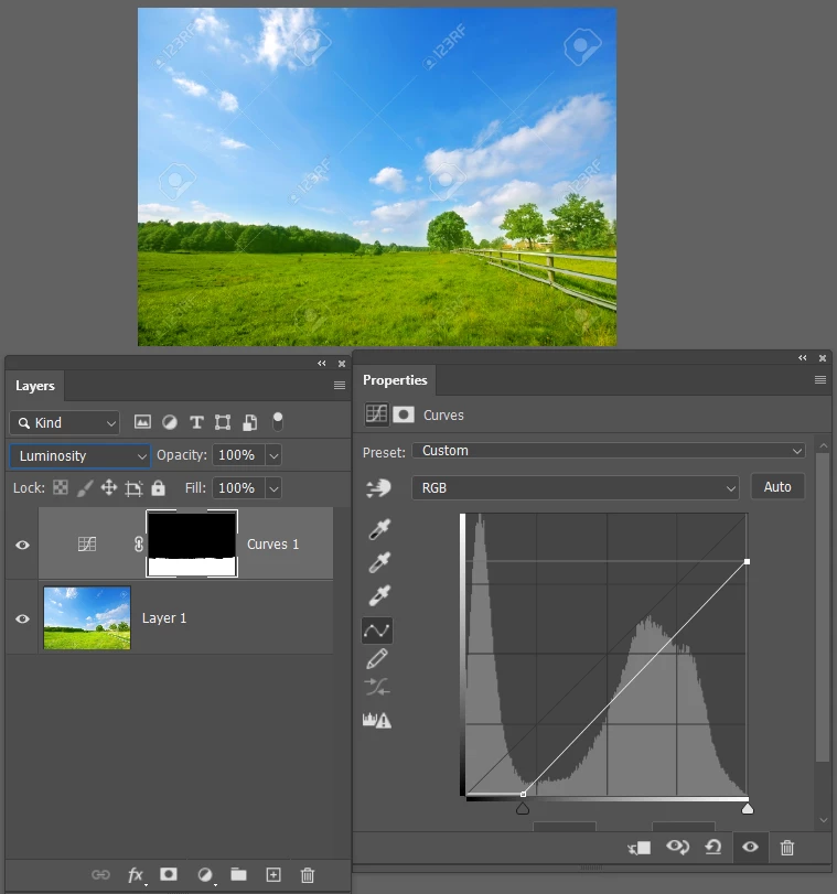

Hey,
I'm trying to mask an image so I can darken the background slightly, and bring out the subjects more. However, when I do this, it still seems to darken all of the image, and not just the area that I have masked off. I guess I am making some sort of mistake, but I am not sure what. I have tried inverting it and all sorts, and messed around with the density slider etc.
Please help,
Thanks
Correct answer Trevor.Dennis
We'd need to see a screen shot of your workspace showing the image and the layers panel to have any idea what is going on.
How are you darkening?  The usual way would be to make your selection...
...and then add a curves adjustment layer that automatically creates the layer mask
Then make the curves adjustment

Trevor.Dennis
Trevor.DennisCommunity ExpertCorrect answer
April 18, 2021
April 19, 2021
Thanks for this, it worked perfectly.
