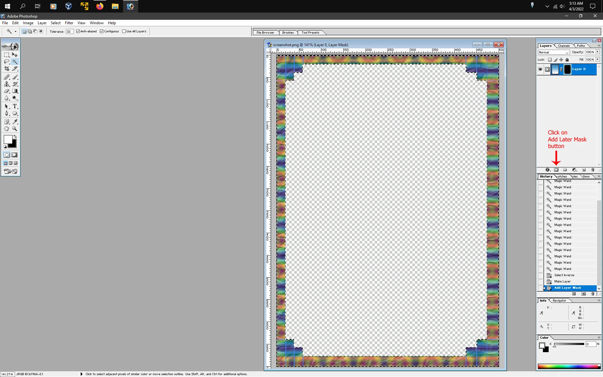

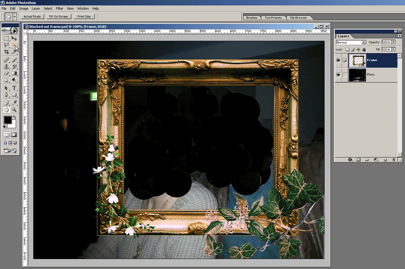

Here is short screen recording:
1. Go to Window>Layers so you can see the Layers palette
2. Click on the Frame layer in the Layers palette
3. Select the Magic Wand Tool
4. Click inside the Frame to make a selection of the area inside the Frame
5. Click on the Photo layer in the Layers palette
6. Click on the Add Layer Mask button at the bottom of the Layers palette
    (that should hide everything outside the frame)

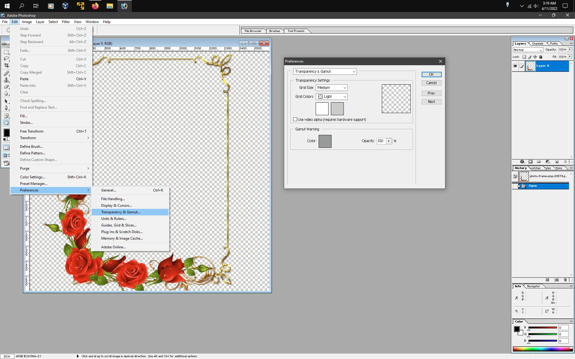

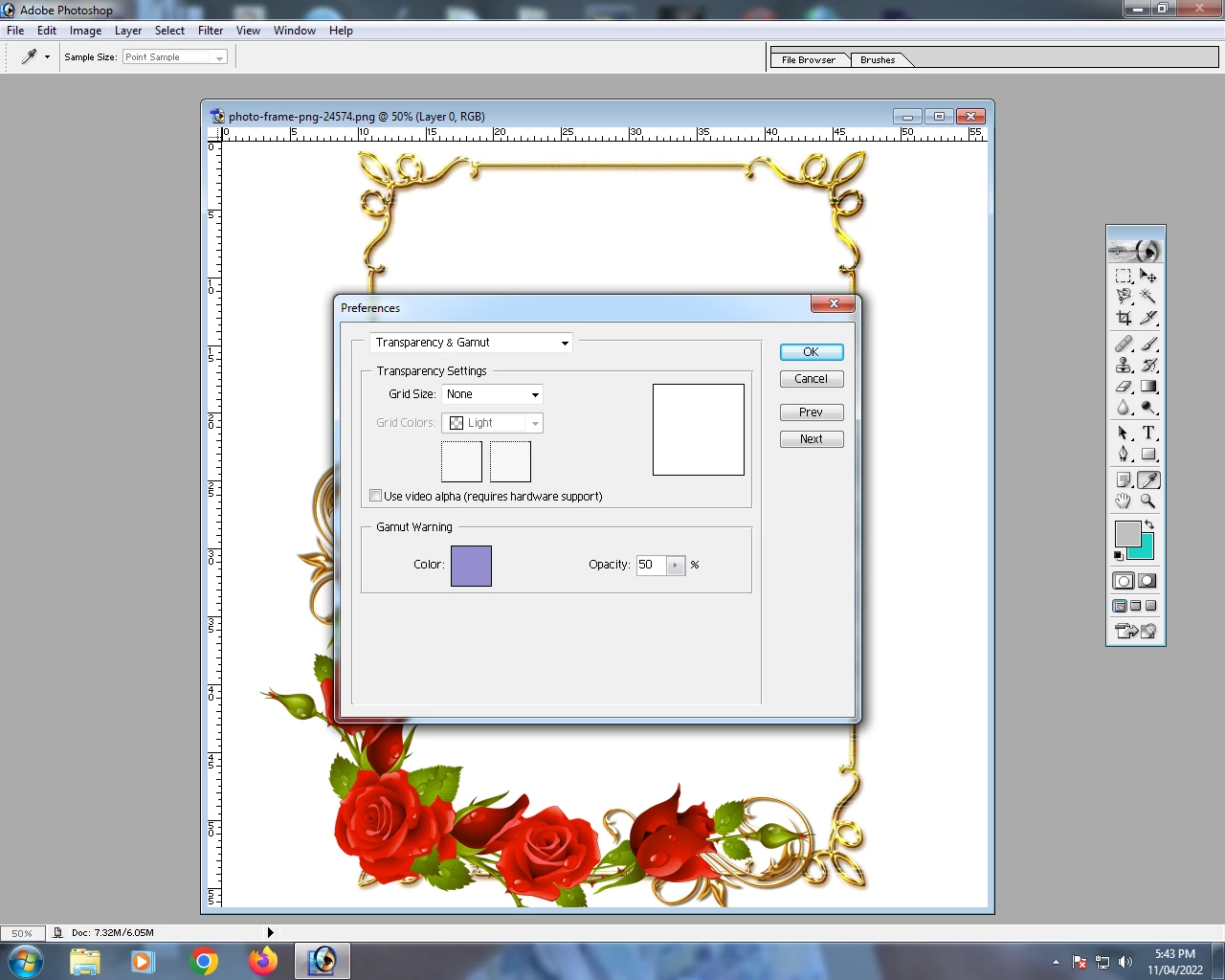

If in ps 7 you go to Edit>Preferences>Transparency & Gamut, what are the Transparency Settings?
Steve747Author
April 11, 2022
Hello. here are the preferences settings. This is becoming frustrating. It must be simple to separate a frame. I want to put it around a nice photo I have in a folder
Steve747Author
April 11, 2022
After I posted the last message message I was able to go to preference and transparency and I managed to change the background so now I can move the frame. I opend up the photo and put it next the frame. So now I have to move the frame around the photo

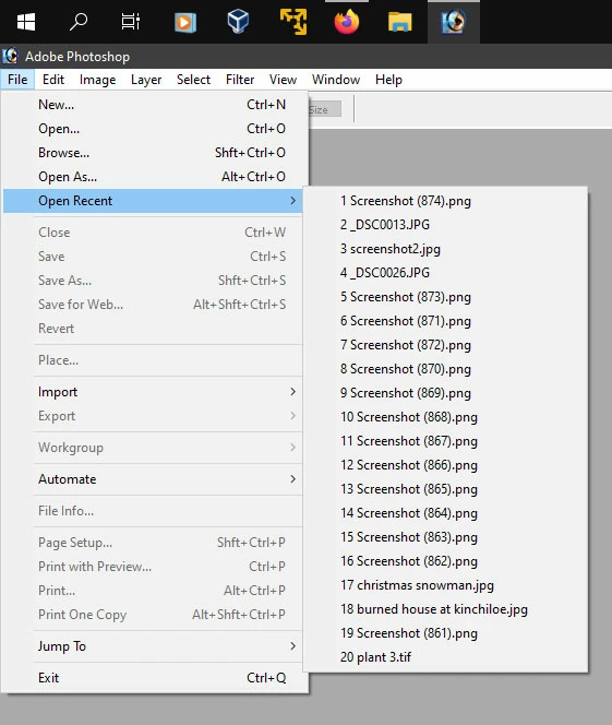

Jeff Arola
April 8, 2022
If in ps7 you go to File>Open Recent, is the file listed there?
Steve747Author
April 9, 2022
Hello. The original file is not in the recents view. I'll try the frame site you suggested but when I went to a site called frames.png I could save the frame but it also came with the white background and I couldn't separate the frame from the background. Thanks

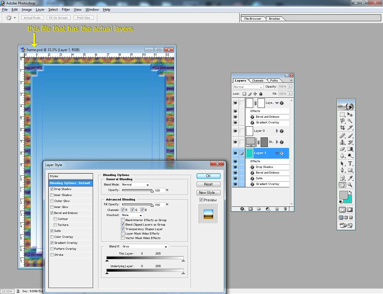

Jeff Arola
April 7, 2022
I meant the actual layered psd file you have open in ps7 named frame.psd.
Steve747Author
April 7, 2022
Thanks for the reply. I'm not very good with photoshop. I have just been clicking all over the place and seem to do things by accident. Where would I find the .psd file that you mentioned?
Jeff Arola
April 7, 2022
The frame.psd file is probably in your downloads folder.
Jeff Arola
April 7, 2022
Can you attach that file to the forum?
Steve747Author
April 7, 2022
It's already on here in a previous post with some explanation but I still can't figure out how to put a picture in the frame which is saved on the computer

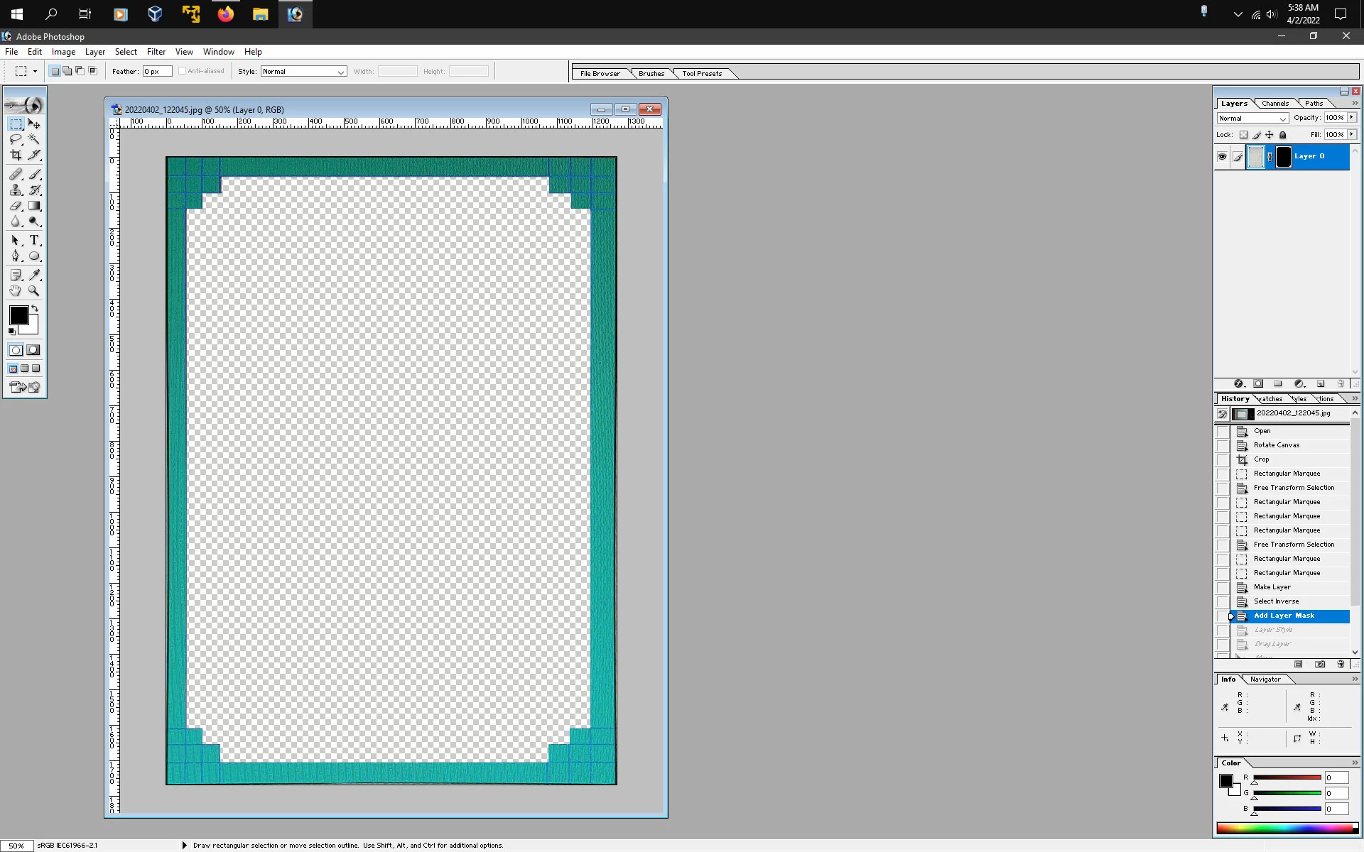

Jeff Arola

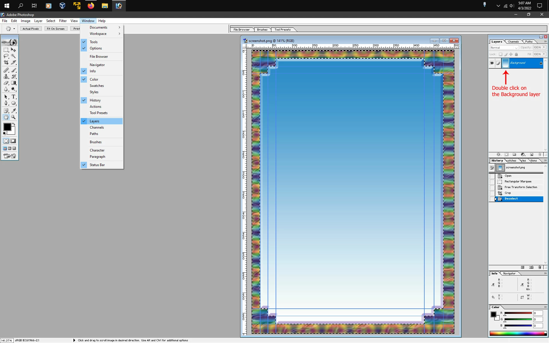

April 3, 2022
In your screenshot it looks like you have a active selection around the frame part.
It would be easier to work with if you have your layers panel visible by going to Window>Layers.
Then double click on the Background Layer thumbnail in the layers panel to turn the Background layer to
a regular layer.
Then click on the Add Layer Mask button at the bottom of the layers panel to make the inside of the frame transparent
Steve747Author
April 4, 2022
Thanks again, I'm sending another screenshot with the layer window open but not sure where to go from here to place apicture inside the frame

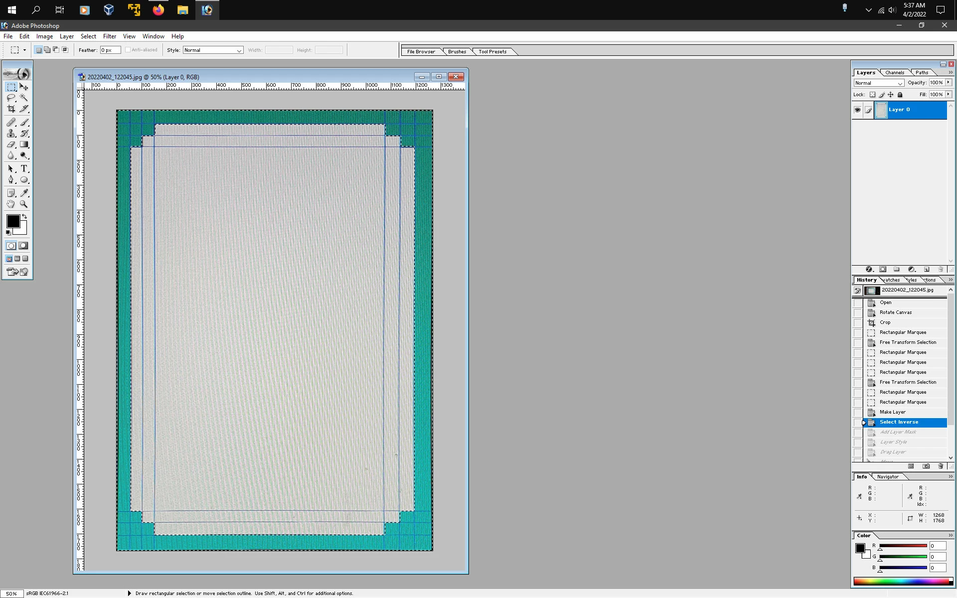

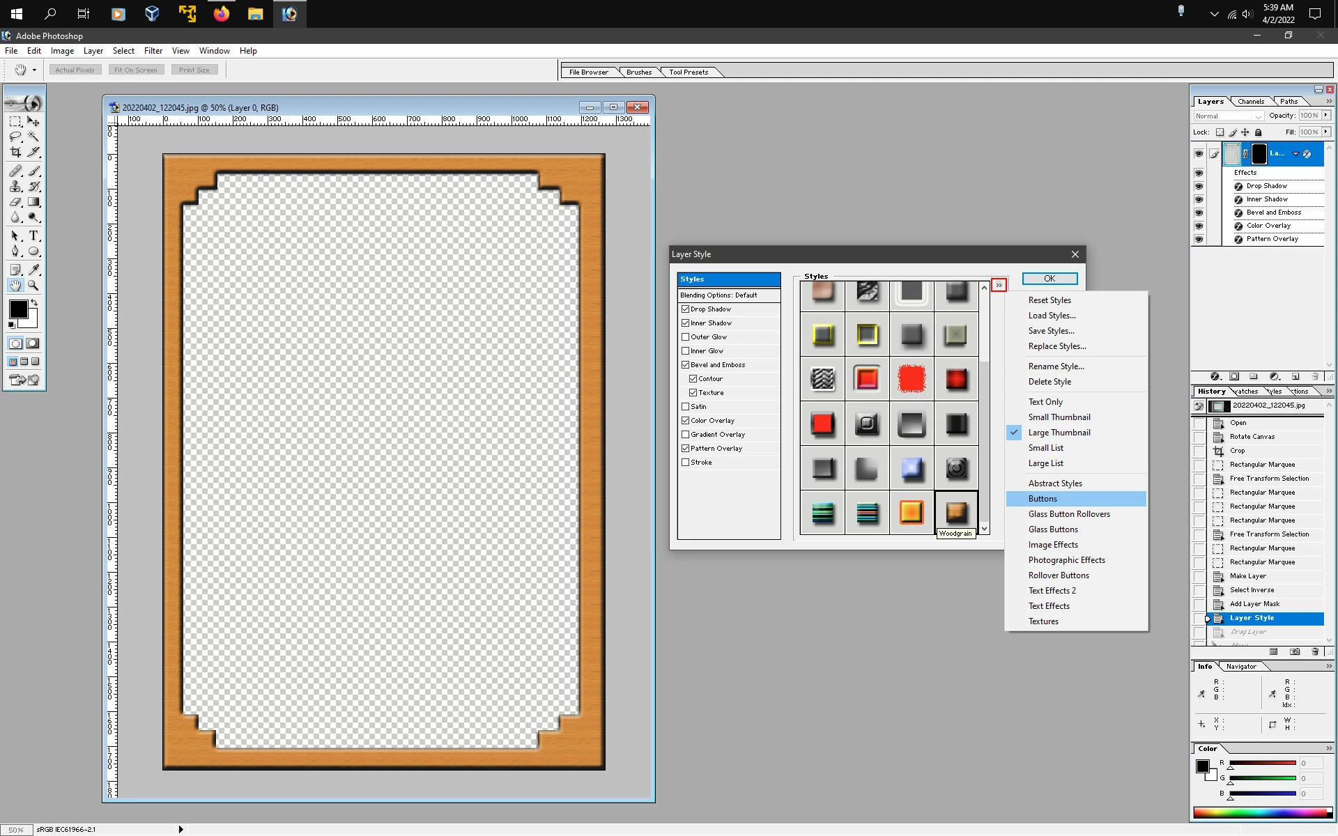

Jeff Arola

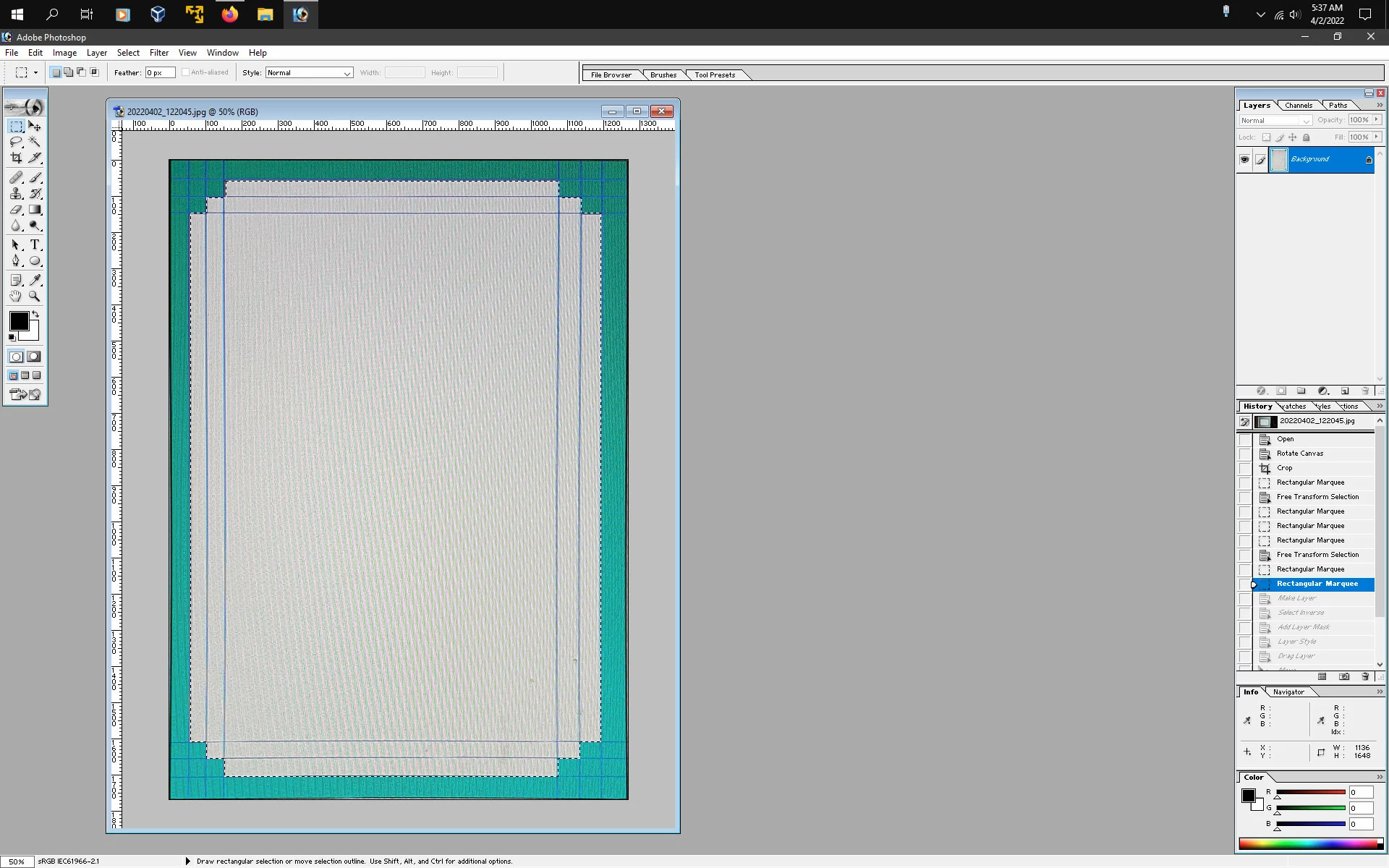

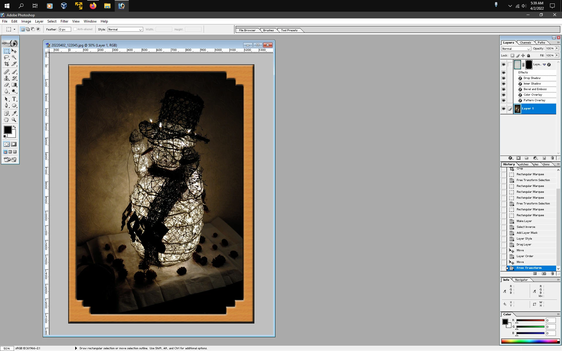

April 2, 2022

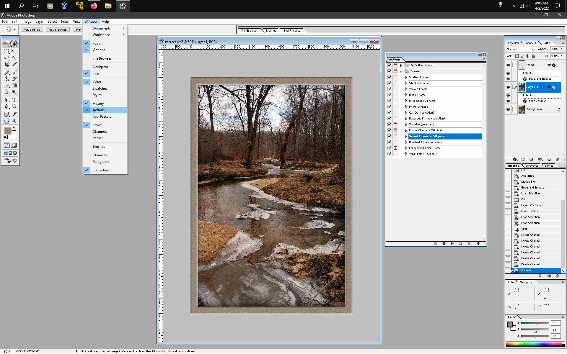

Here's what i did using your example:
1. Used the Rectangular Marquee Tool to make a selection of the White Area
    (if the original is a solid color like white then you could use the Magic Wand Tool
      to click on the white to select it)
2. Inversed the selection by going to Select>Inverse
3. Double click on the Background Layer to make it a regular layer and then add a layer mask by going to Layer>Add Layer Mask>Reveal All
    (that gets rid of the white)
4. Added a layer style to mimic woodgrain by going to
    Layer>Layer style>Blending Options, clicking on the word
    Styles, then clicked the flyout menu, clicked Buttons and selected Woodgrain
5. Put a photo under the frame.
There are quite a few Frame actions to download here, that were made around the time of photoshop 7.
https://www.outdooreyes.com/actionsindex.php3
Steve747Author
April 3, 2022

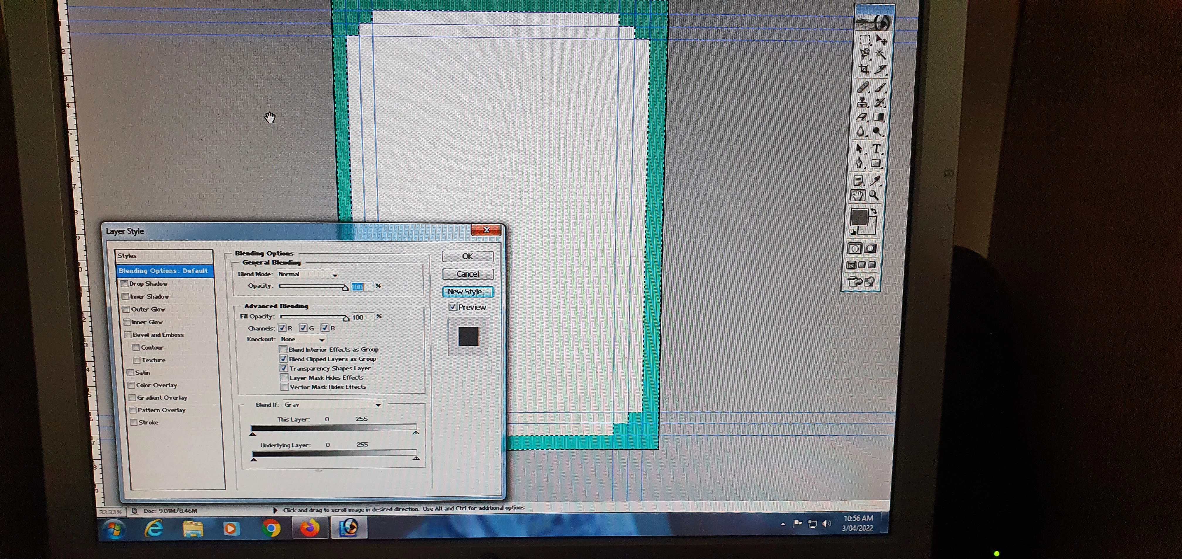

Thanks again. Not having much luck, see the attachment. I still can't get rid of the white inside the frame. There seems to be nothing inside the actions box. I can't see any frame styles in the layer styles flyout menu also
jane-e
April 3, 2022
@Steve747
Please show a screenshot after you have done steps 1, 2, and 3 in Jeff's instructions.
Jane

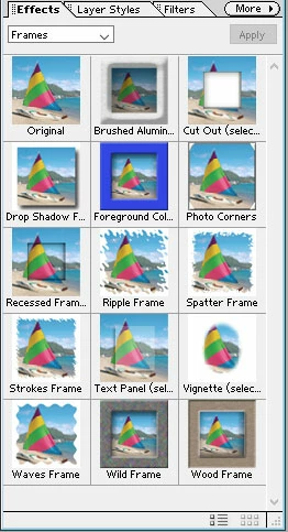

Jeff Arola
April 2, 2022
Do you have a particular kind of frame in mind?
If in ps7 you go to Window>Actions you can load a variety of Frames actions from the Actions palette flyout menu.
what the different frames look like

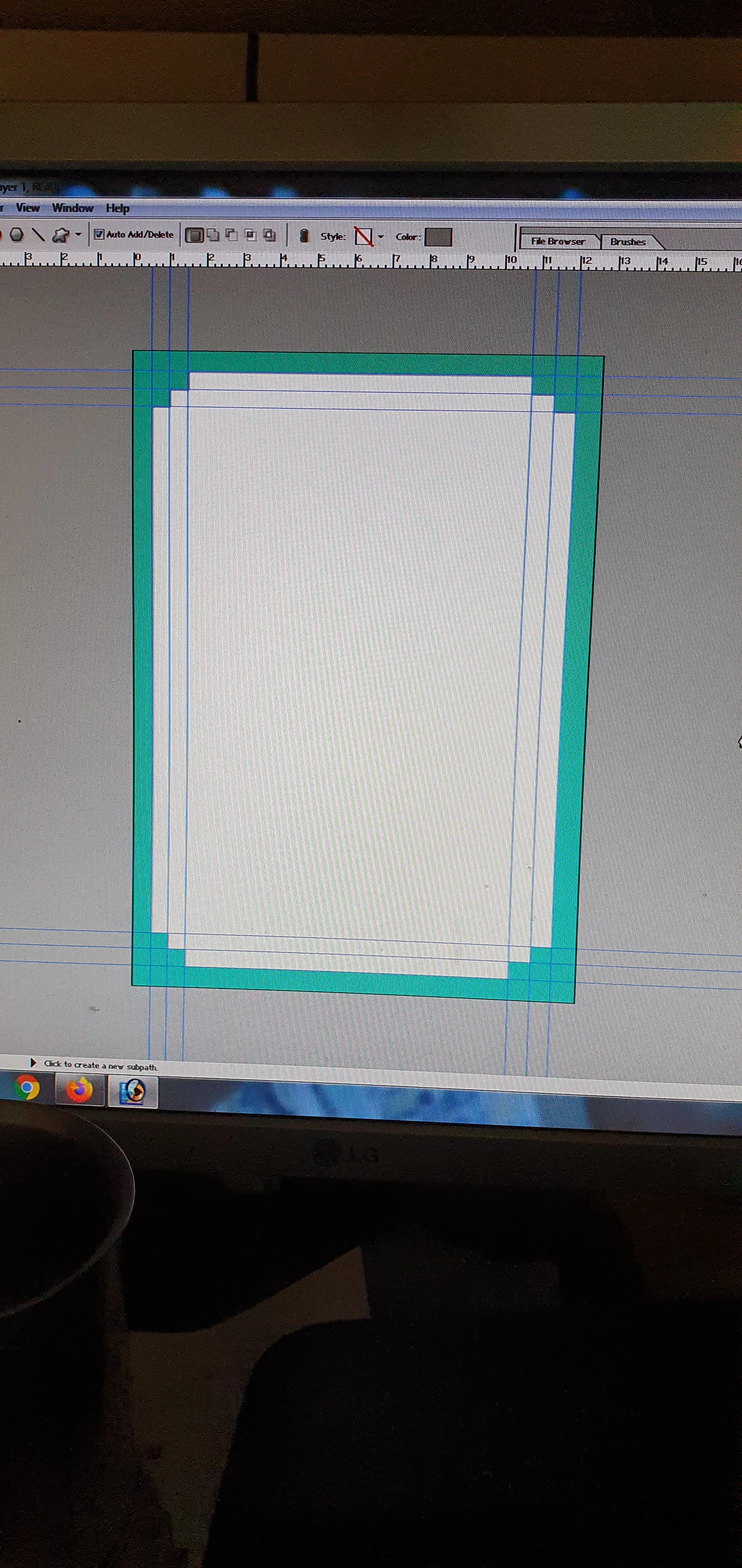

Steve747Author
April 2, 2022
Thanks for replying. When I tried to download frames. I couldn't separate the frame from the white background from the website. One tutorial made it look easy. I'm attaching a photo of what I've been trying to do. I want to change the plain blue frame to maybe a wooden look
