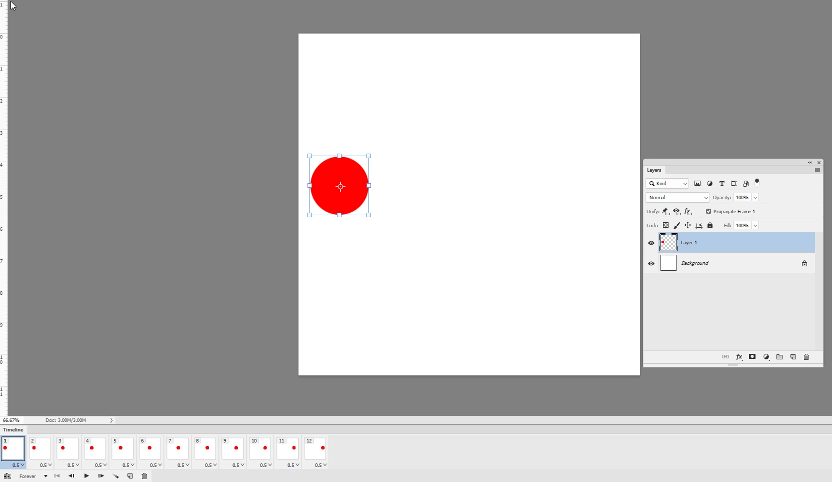

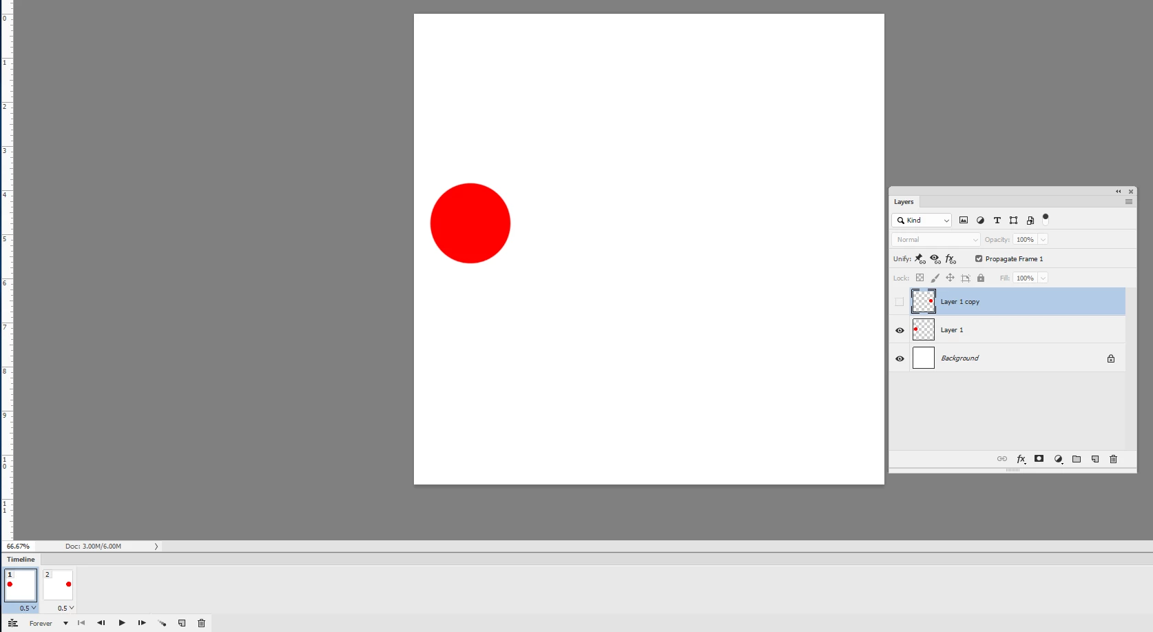

    If your frames are based on different layers then the "tween" menu item works by inserting frames and creating a "dissolve betwen them i.e. fading out the first frame and fading in the second second.
    Before tween :
    After tween - see the fade between the layers in the timeline:

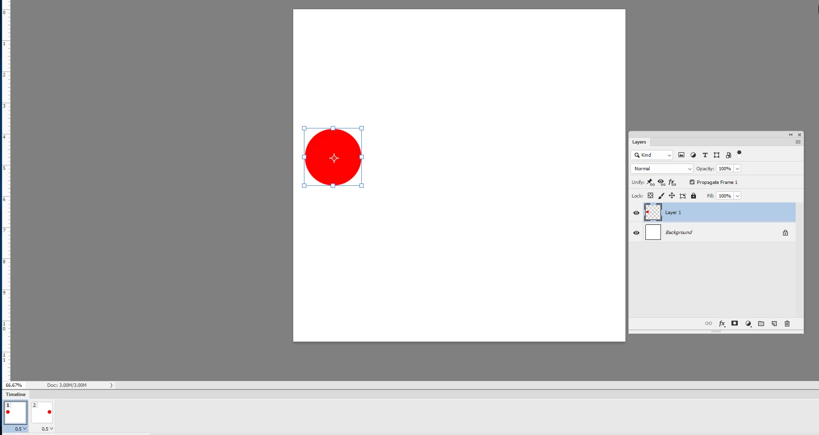

    However, if your frames are based on the same layer but with the position of the layer moved - then the tween will generate "in between" positions on each frame:
    Before tween
    After Tween (note the frames showing the moving position of the layer in the timeline
