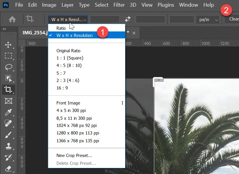

I am having two problems in PS 2024.  The first is in cropping mode.  How can I custom crop a photo? The crop feature is tied to a preset ratio which makes custom cropping impossible        epson printer.
By @rshenkma
Choose WxHxResolution then click on Clear button in the Options bar. Drag freely to set crop rectangle. Is that what you want to ask?

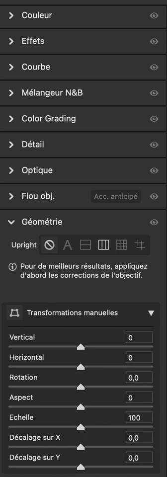

To correct leaning verticals, convert to smart object then open Camera Raw filter, then go to Geometry
Use the third button
Regarding the croping make sure that nothing is specified in these fields
