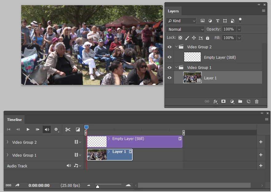

Have got past this?  It's been 15 hours since you posted, and no reply.
You can drag a video track forward, which will extend the timeline.
You can add another video group.  Put a layer in it and drag to extend it.
