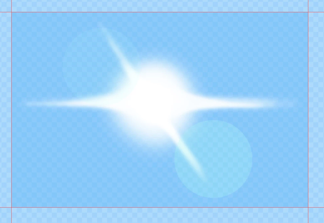

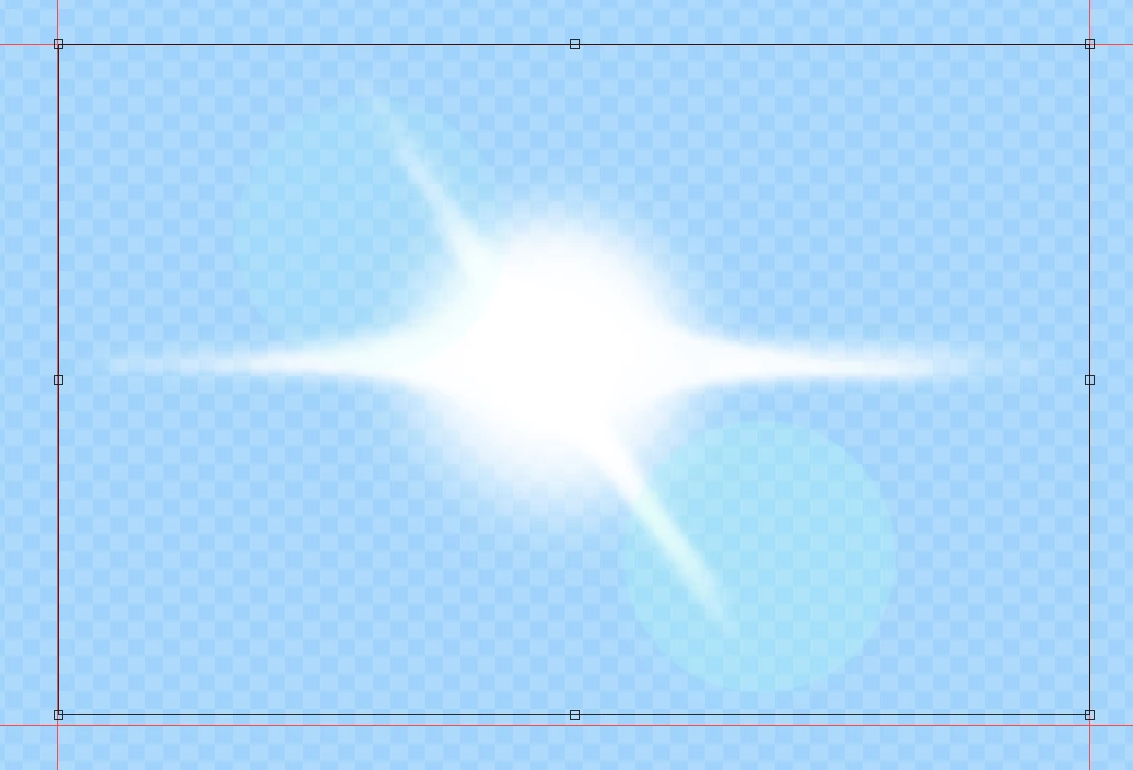

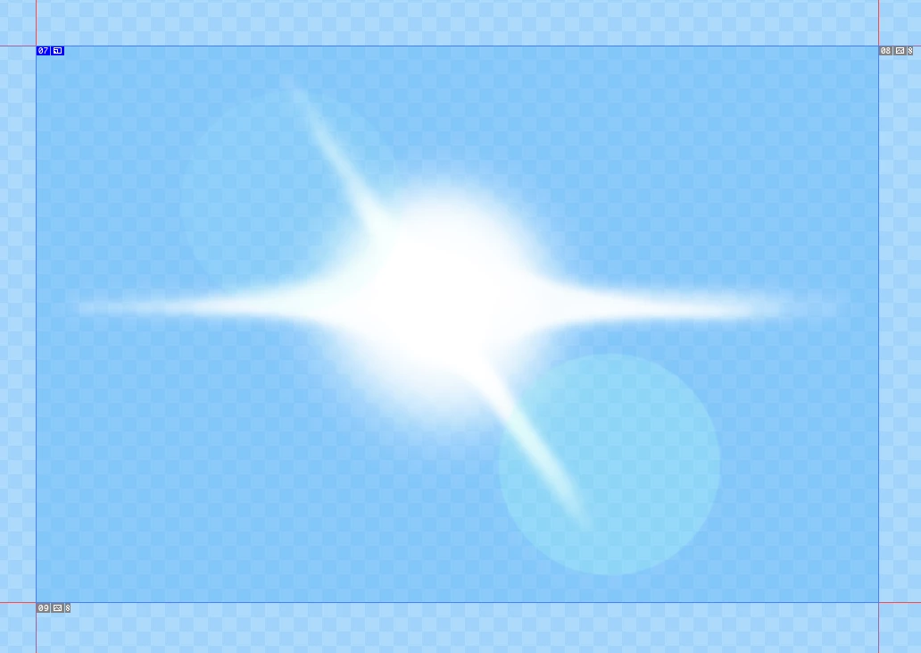

Here is my workflow:

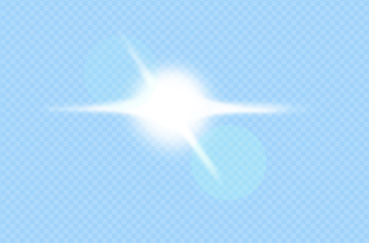

The asset, it's unclear to see its boundaries without a bounding box.

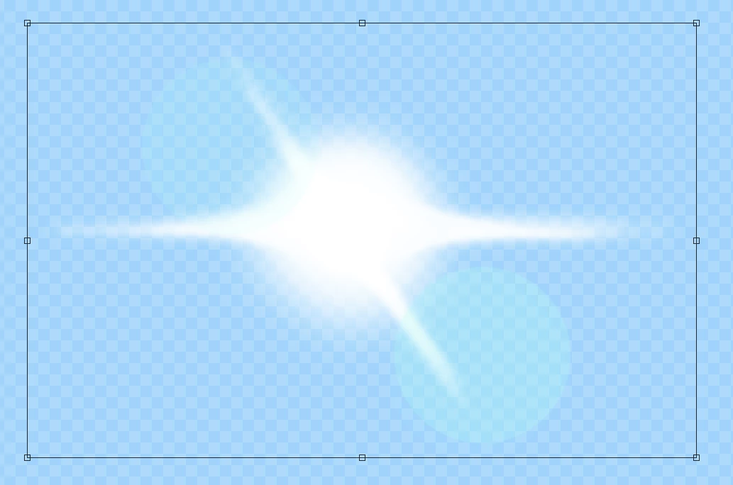

I use transform tool (CMDT) to see the boundaries of the asset
Using guides to define boundary of asset
(this is the bit that has become a headache for me, how that i cannot drag guides onto canvas is transform tool is active. So now i have to do a lot of guess work in between activating cmd-t to see where the boundaries are. )
creating a slice guide box using guides as reference
Creating a slice using the slice guide
