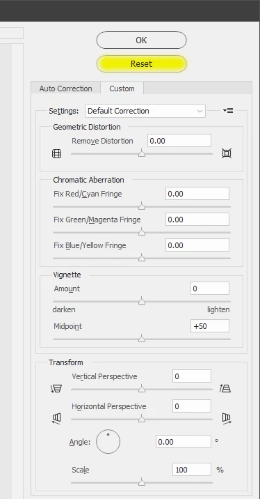

Anyone know if it's a feature or bug to not have the undo/redo options in the Lens correction filter window?
Every time when I draw a line to straighten the image, if I made a mistake I have to cancel and exit from the lens correction dialog box and reopen it to start over. Anyone have any idea on this, please?

Yes the undo shortcuts don't seem to work in the lens correction filter, even back in photoshop cs2, the first version with that filter, so i don't think it's a bug per se, but would make a good feature request that can be posted here:
https://feedback.photoshop.com/
In the meantime you can press the Alt key and click Reset to return all settings to Default
rather than close and reopen the filter.

@Jeff Arola Thank you so much to clarify that. And I really appreciated your suggestion on a workaround so that I don't have to close the filter and reopen it. However, I'm so curious, what's the logic behind this not having the Undo/Redo option in the Lense filter.
