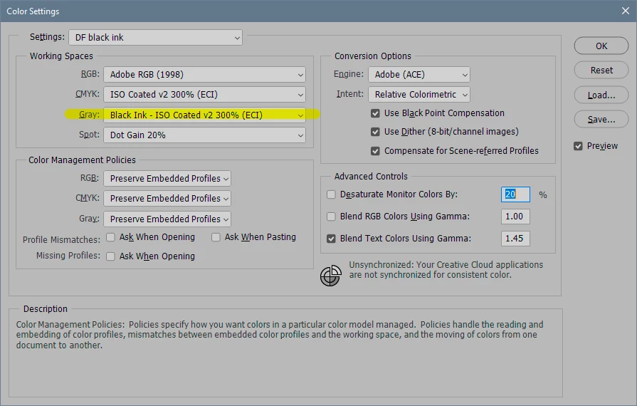

For offset print, there's a more elaborate solution. This is what you need to do for grayscale files going to InDesign and further to offset press, for instance (replace CMYK profile for whatever appropriate):
Bottom line, I need to stress as strongly as I can: the problem here isn't color management. The problem is lack of color management.
