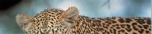

I am a fairly experienced Photoshop user. My problem is as follows. When I select and edit the tone, saturation, etc of an object in a photo and separately edit the background, occasionally I am not happy with the transition between objects. Of course I know how to use feathering, and I know how to shift the edge of the selection to soften the transition. I sometimes use the blur tool to soften the edges. Regardless, they sometimes look "photoshopped." Can someone help me with the subtleties of technique here?

Norman Sanders
January 18, 2021
You have described an image on which you made a Selection and modified the area, then Inversed the Selection and modified that area. You found the Selection edge is too apparent. The following is a technique you may not have tried: It softens that edge using a separate layer and a blur over which you have control of blur width and blur amount.
The additional step:
With the Selection marching ants still showing, choose Select > Modify > Border which will change the Selection’s marching ants to a double marching ants selection, an "avenue" that seems to straddle the area of the original selection.
Cmd+J will put this area of the image on a separate layer.  Hide the marching ants (Cmd+H). Apply a Gaussian blur to soften the edge where the separately modified areas butted. Each image you work on is different and may require a different amount of softening. Via drop down menu for Border and Blur, this technique gives you full control over the width of the “avenue” and the amount of blur. One more thing: If there is a section of the contour that doesn't need the gentle blur, just remove that area from the "avenue" layer. Good luck.
January 19, 2021
This is a feature of Photoshop that I was unaware of. The after-the-fact adjustability is ideal. Thanks so much.
