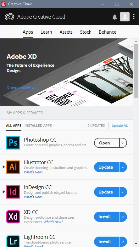

    First you open the CC app and see this. Click "update" next to the app you want:

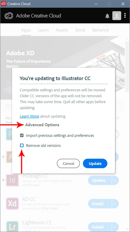

    Then you get this. Open "advanced options" and uncheck "remove old versions":
    If you do, however, decide to remove the old version, you should always uninstall the newest first, then the older. Then reinstall the new one. Photoshop should always be installed in strict version sequence, and uninstalled in the reverse sequence. Last in - first out. Otherwise you might get into trouble with file associations getting stuck.

    Thanks to all for prompt replies with answers. My problem was that I
    couldn't see Advanced options as I was afraid to click on UPDATE (next
    to most recent version) because I was thinking maybe Adobe would go
    ahead and update to latest version and overwrite/uninstall older
    versions, without asking my input in the matter.
    I had been clicking on the drop-down arrow to the far-right of the
    specific version of PS CC I was interested in, only in the Installed
    Apps tab. There is a "Manage >" line but it leads...nowhere.

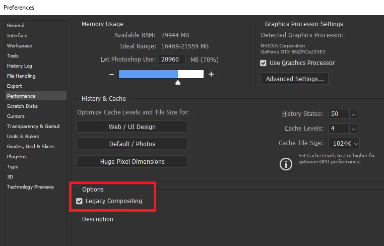

    Hi
    To save yourself some headaches with CC2019, enable these options in preferences, both are disabled by default.

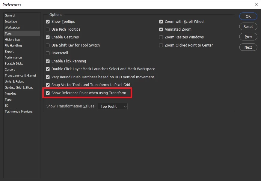

    and this as well

    Hi there,
    As you want to keep the old version of Photoshop, one you click on Update a prompt will appear where you'll see "Advanced Options".
    Click on "Advanced Options" to expand the choices, you will be able to keep the older version also your settings will transfer to the updated version.
