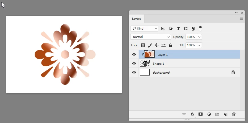

Hi Sandee
You could add a layer above the shape then clip that layer to the shape and use the gradient tool on the empty layer
If you need to bend the gradient you could go on to warp the upper layer
Dave
