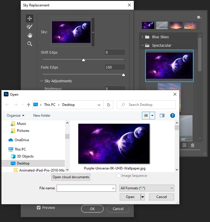

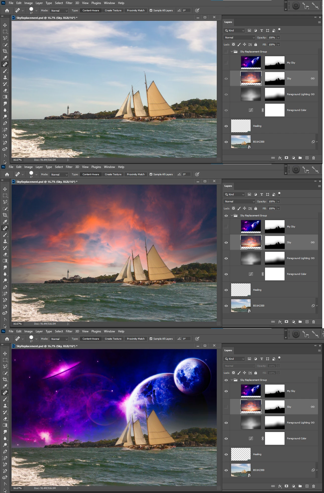

You cans use the tool the replace the sky then use the mask created on your background image.  The tool is one designed to create mask for the sky in an image. The Image need to have a sky that can be masked.  Once you have the mask its created copy it onto the background image you want to use and delete the sky replacement group added.
And you can add Sky images\ to the Sky replacement tool.
