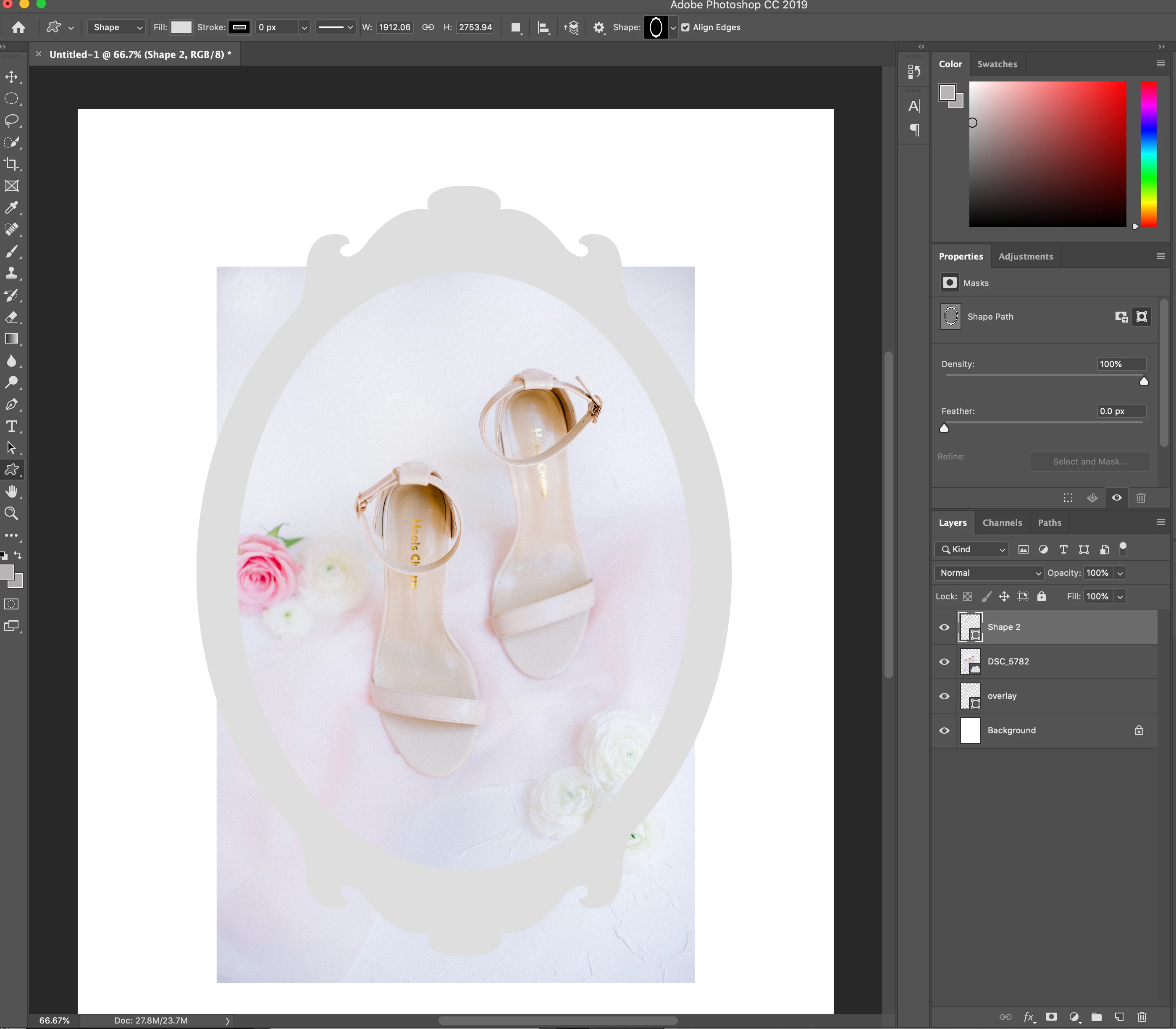

See below image for reference:
How do I make the image disapear on the outside of the border? I am wanting to export this as a transparent background to use for my website?
Also, is there a way to make the border of the shape thinner?
Thanks!

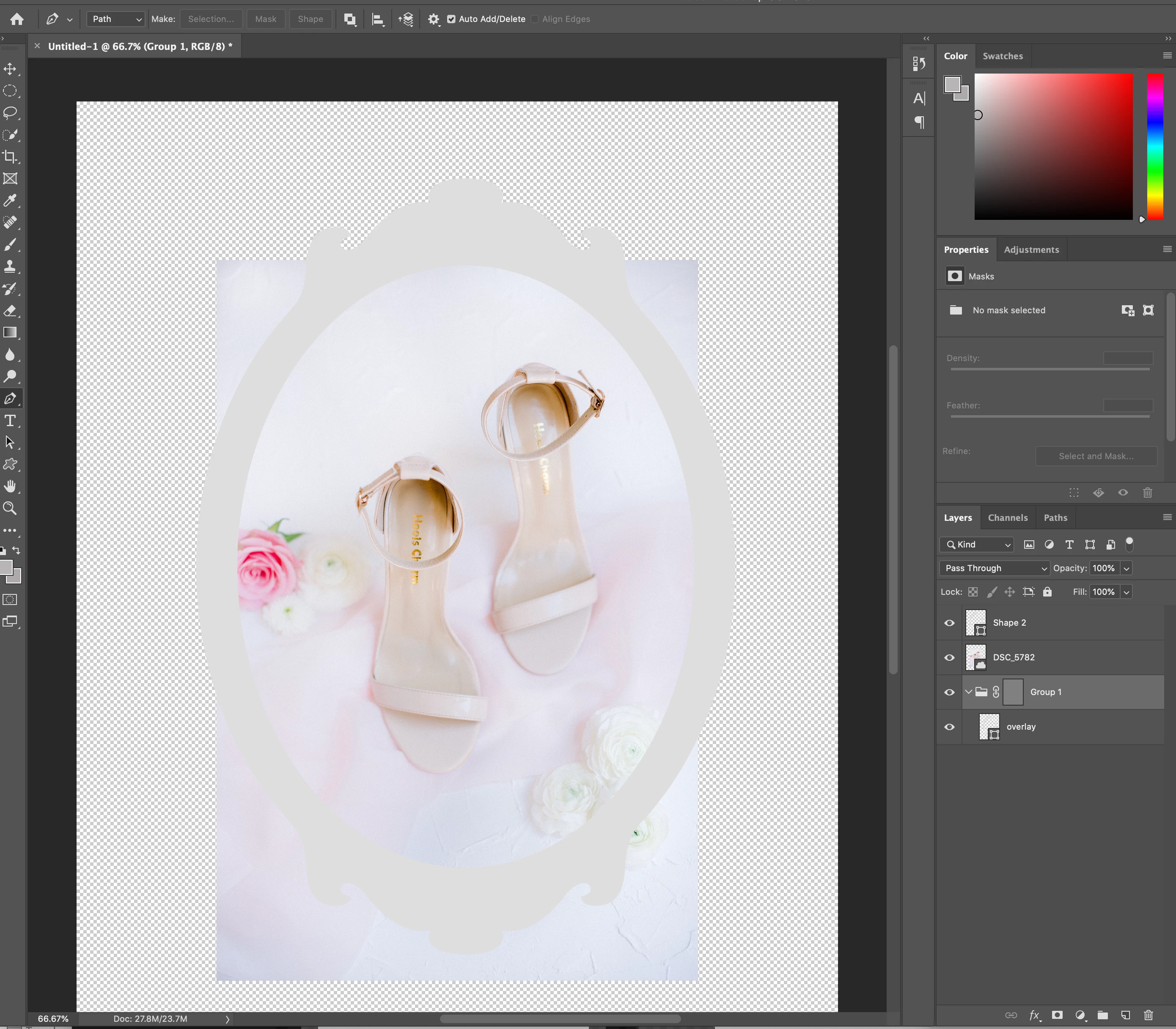

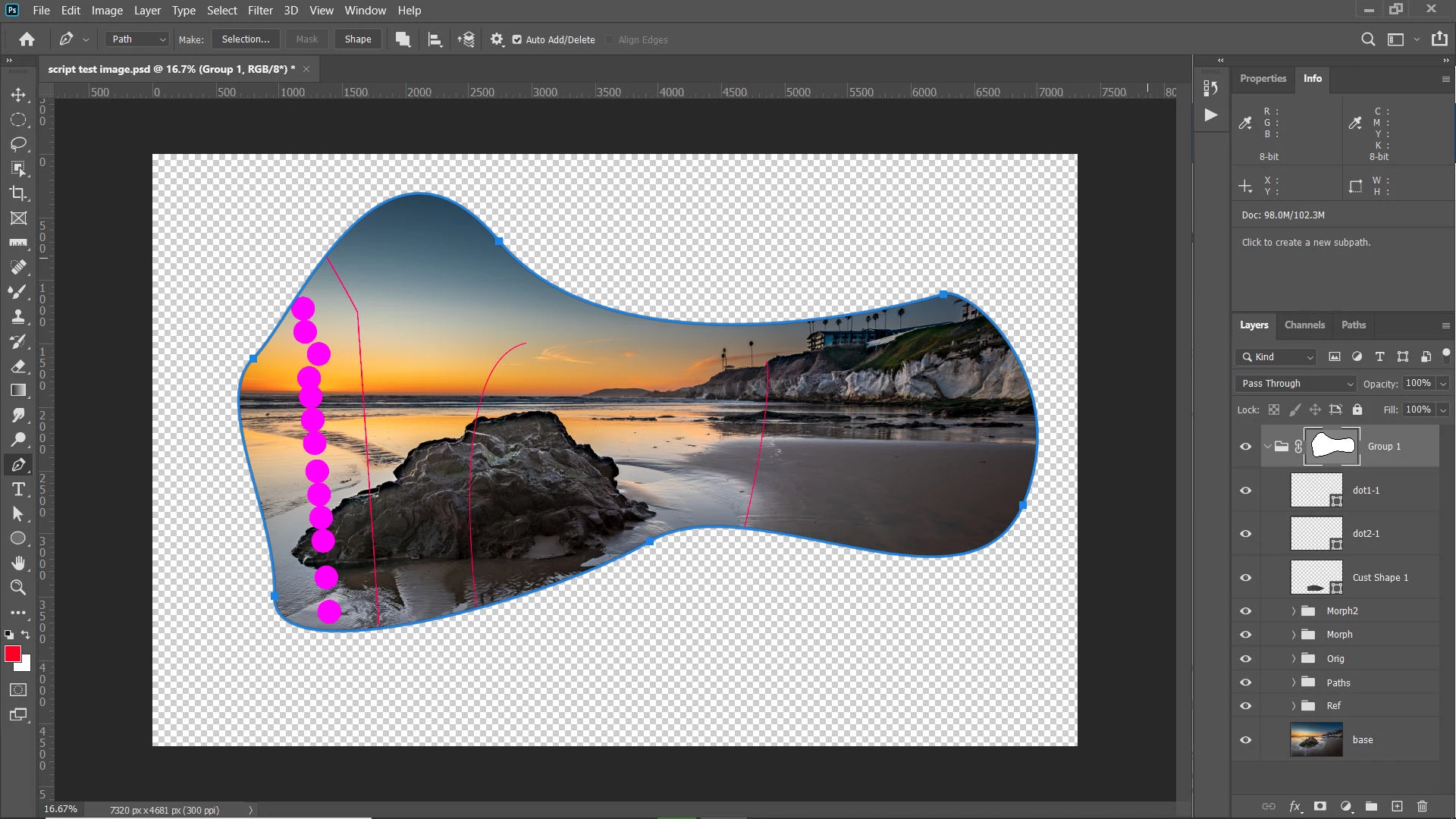

As in my screen shot, put all layers in one group. Use the pen tool set to path and create a path where you want the frame to be. Then ctrl/cmd click on the mask icon in the layers panel while the group layer is selected and while your path is still selected.
Chuck Uebele
Chuck UebeleCommunity ExpertCorrect answer
January 28, 2020
kristip62558545
January 29, 2020
Chuck- It worked!!! Thank you very much!

Hi JJMack, thanks for your response. I have done that, but still see part of the image on the outside of the frame, which I am not wanting. I don't know how to get rid of the image on the outside of the frame. Thanks!
JJMack
January 28, 2020
Then you posted the wrong screen capture or the is there is something I can not see in your screen capture. That content is not in your screen capture. There are no layer hidden by layer type filtering, There are no layer mask shown and no later is clipped. The content you are referring is not the background layer for you turned off its visibility.

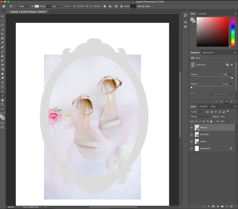

Is it that the white background layer also forms the center fill of the frame? If so, you can also:
-With the pen tool on the frame (shape) layer, make a selection (in Windows, it's Right Click>Make Selection)
-Select>Inverse
-Go to the white background layer and do Edit.>Cut. The area outside the frame will be cut, while the center of the frame remains.
kristip62558545
January 28, 2020
I tried to follow your steps but the inverse was in light gray and was unable to click it. I am up for trying a whole different way.
