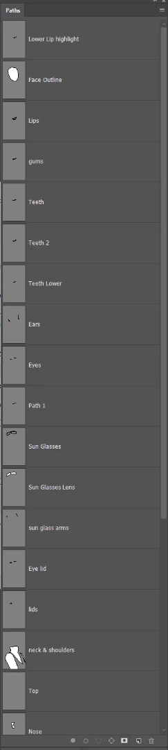

I use work paths.  They are east to make totally accurate with smooth curves, and can be adjusted as you go.  You can then build the finished art work a layer at a time using those work paths.  This is the way that Bert Monroy does his digital portraits as in this detail shot of Bert's Times Square Gigapicture

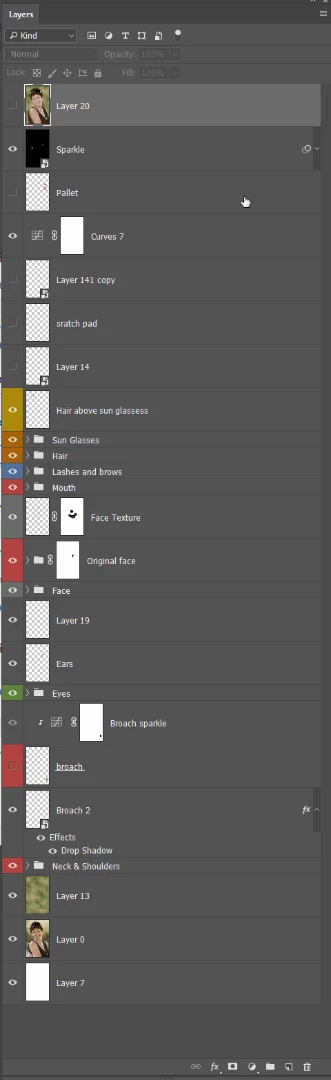

There are just under 100 layers, but many of them are Smart Objects with multiple layers, so the total count would be a fair bit higher. The broach and earrings were produced separately using Photoshop's 3D tools.  A good 90% was done with brushes from this brush set by Castrochew, but I made other brushes for stuff like eyebrows using Fade to taper out the lines.   If you are using Windows, then Lazy Nezumi Pro is a huge aid.  A tablet is an obvious must have.
