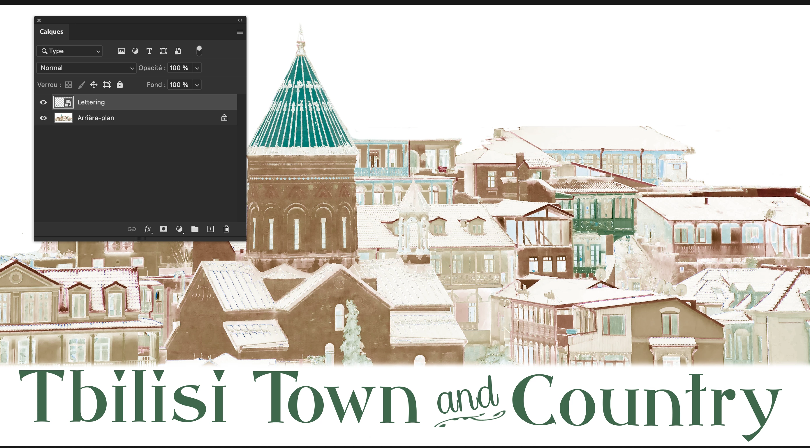

  4. Actual result and actual result  via screen shot:

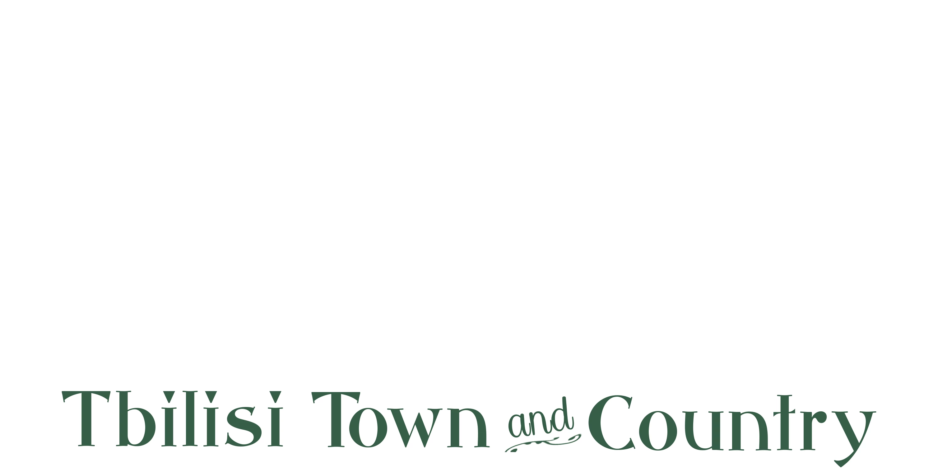

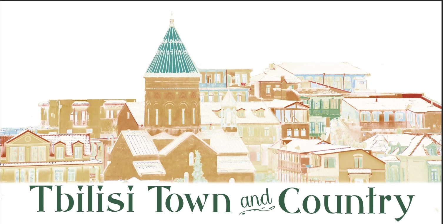

  5.  l was hoping for this (above) , but get this on export: (the graphic dissapears)

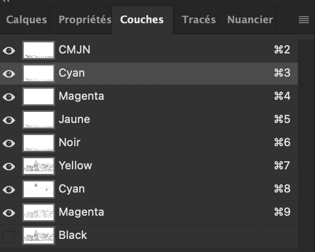

Checking your PSD file shows many more chanels than necessary…
And also there is no layer for the town, only for the lettering
I would first reorganise all this mess

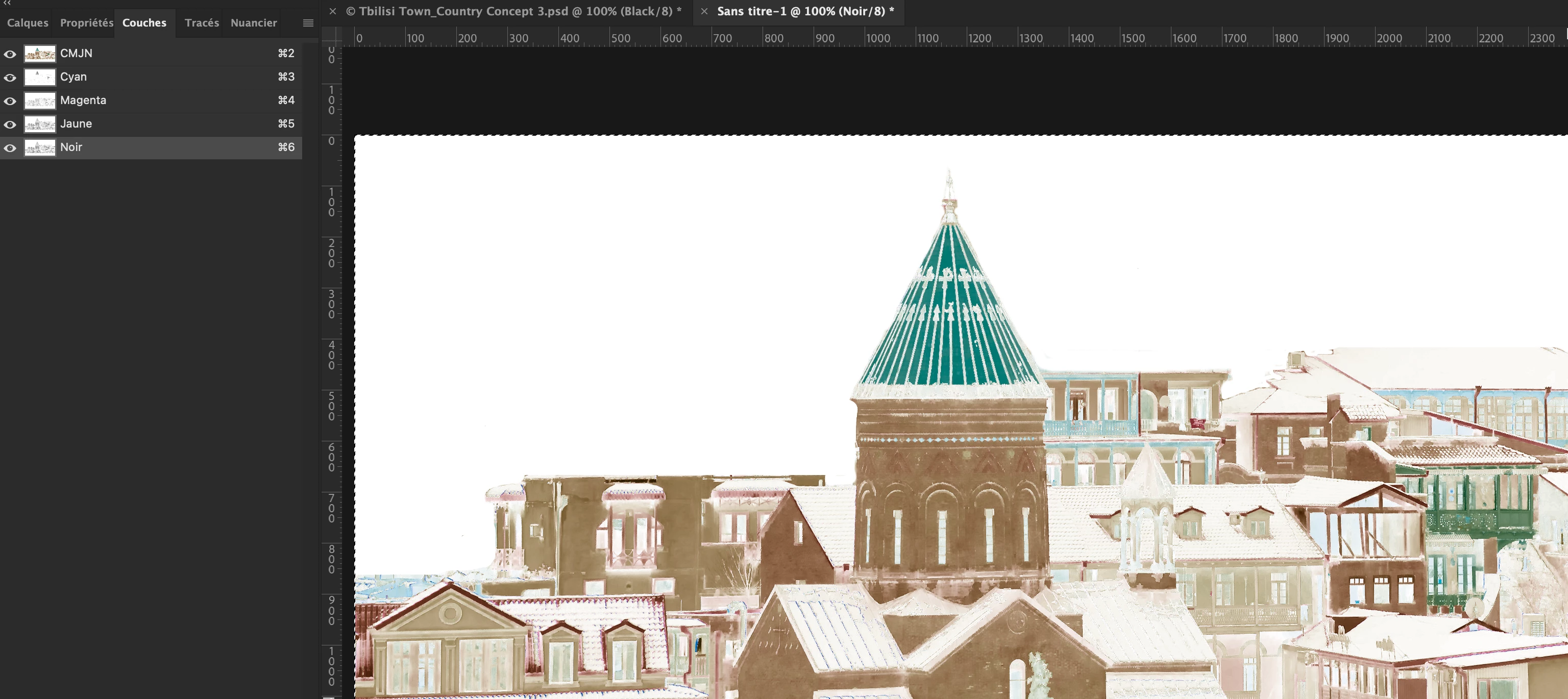

You can create a new doc same size CMYK
Copy and paste the CMYK chanels one by one to get a clean doc
Then add the lettering layer on the new doc (after getting rid of its white background)
You have now a clean doc you can work with, print  or export…
 File added
